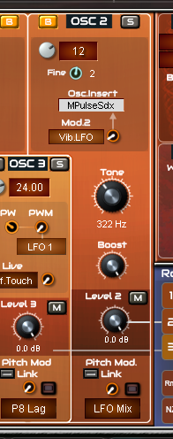

Using BB2 Oscillators and filters in Neodyne
Oscillators
The BB2 or BB3 insert oscillators are not meant to be useable standalone, they need a synth "host" that will take care of the oscillators frequency (pitch, pitch bend, portamento, pitch modulations).
On Neodyne, you can access the inserts by pressing the "B" buttons near the oscillator label. It will bypass the included oscillators, and will also use the BB oscillator as a source for the ring and Osc modulators. Some oscillators offer a second modulator, which purpose depends on the oscillator. In general it will be used for PWM, but could also be used for something else, such as wavetable "scanning" . It really depends on each oscillator.
if you want to use BB oscillators outside of Neodyne, you can use them in the "BB3-Osc BB2" which has a VCA.
You can also use the oscillators "standalone", by connecting the InR input to a device that sends pitch in Scope format, such as the sequencers of BB3 Full pack. However, this is a bit more complicated to setup. It could be used to send the oscillator sound to with a eurorack that has filters and VCA's, or another scope synth with audio inputs.

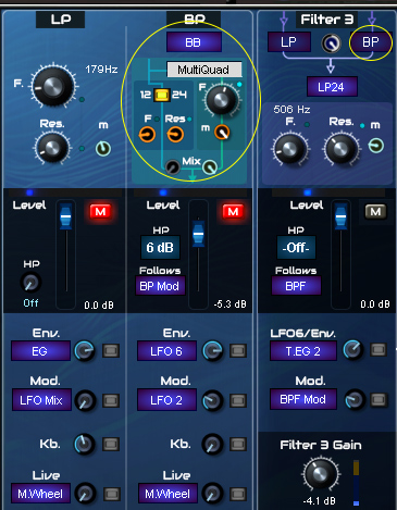

Filters:
Filters need one input for audio to be filtered, so they can only have 1 modulator input. As modulators are mixed "pre-insert-inputs" , the single modulation input has no consequence on the complexity of the filter modulations.
In Neodyne, you can use insert filters in Filter 2 (BP) only. It will be used in parallel to the original BP filter. You access the insert slot using the BP menu, by selecting "BB". It uses the same modulator mix as the BP filter. You can shape this filter further by selecting "BP" as a source of Filter 3.
On the picture below, Both LP and BP are "pre" filter 3, becauyse they are muted from the filter mix. if you unmute them, they will be parralel to filter 3, and chained at the same time (as they are the sources of Filter 3).
Oscillators
Filters:
- filters.jpg (123.97 KiB) Viewed 18900 times

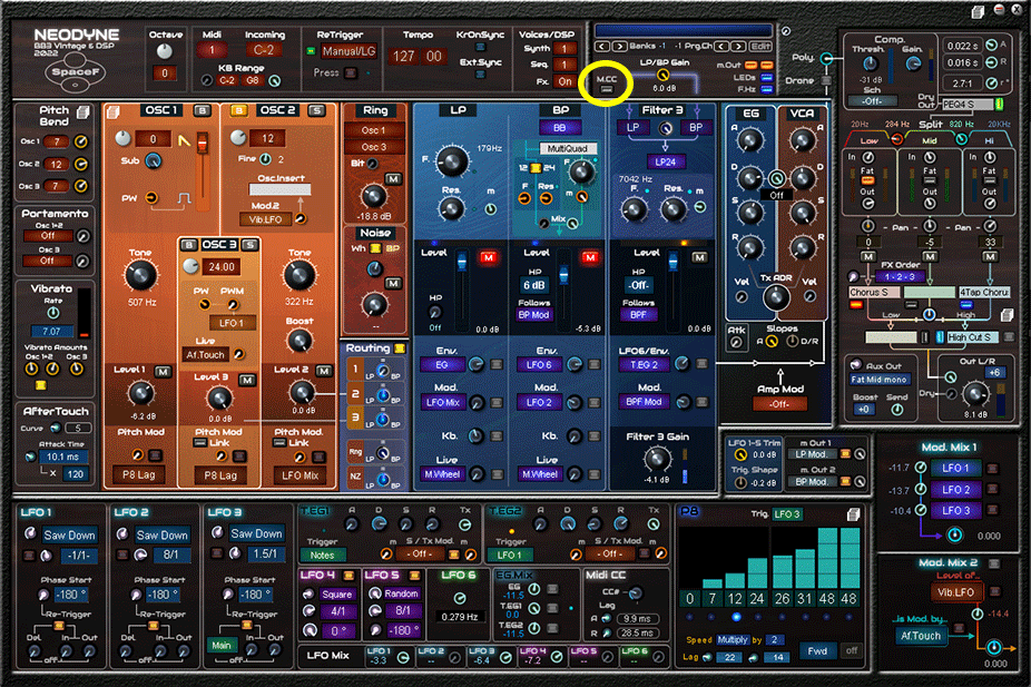

MCC
Click on the MCC button to show small potis that you can assign to Midi CC , allowing to remotely select most menus. In general, the menus are for modulators but some of them have other functions. The potis are placed "where there is room", but it should not be difficult to know what they do just by looking which is the closest menu. There are a couple of menus that do not have such potis (mod outputs and sequencer triggers for example).
I suppose that the most courageous users could use this function to change modulators without using presets, by programming the changes in a DAW. it can also be used to change modulators manually using the potis, eventhough this is generally less convenient than using menus. A useful function to remote control would be the HP type of Filter 2 and 3, or the Ring source (probably the best use for MCC) , or the Filter 3 sources . Anyway, the feature is there if you need it.
Once the potis that you need are assigned, you can simply hide them by pressing the MCC button again.
- anim-MCC.gif (648.27 KiB) Viewed 18871 times

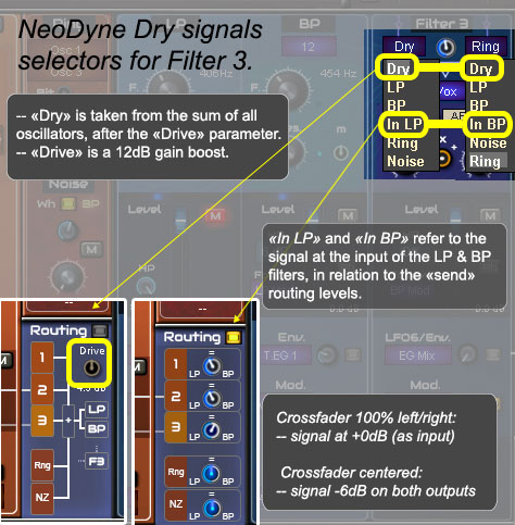

Here is some more info about the available "dry" sources for Filter 3.
- "Dry" is the signal from the "sum" routing.
- "In LP / In BP" mean "Input of LP/BP" and refers to the signal sent to LP and BP with the "send" routing.
- Noise and Ring are also dry or unfiltered signals.
-"LP/BP" refer to the outputs of the LP and BP filters. These are not "dry" signal, because they are filtered.
All routings are available all the time as sources for Filter 3, even if they are not the currently active routing.
- The "Drive" of the "dry routing" allows clipping the oscillators mix. the "dry routing" could have been called "classic routing" because it is similar to the mixer of classic synths. Putting the drive to zero allows softer sound, while putting it to the max produces more aggressive sounds. Also remember that for both routings, the volume is first set with each oscillator "level" poti. Do not hesitate to go to low levels at the oscillator stage, for the best balance and softness, and then boost at the poly/comp/output stages.
When LP or BP are selected, a +6dB gain becomes available. It acts on both LP and BP input levels of Filter 3. It is not more than +6dB because it is already loud and likely to clip, especially when Resonance is used on the LP or BP filters. The 6dB gain is common to LP and BP, but you can adjust the balance of both sources with the Filter 3 "source crossfader". if the 6dB gain clips, just set it to the minimum position, then boost the sound with the "Filter 3 Gain" potentiometer located at the bottom of Filter 3.
- ManualNeodyne-Dry.jpg (71.84 KiB) Viewed 18233 times

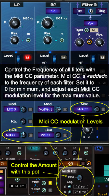

NeoDyne contains several "macro" parameters that can be used to control several parameters at once.
Such Macros are essentially for ADSR live controls:
- Tx is a classic time-expander that stretches ADR parameters by a factor 100 (from x 0.1 to x 10).
- The Decay Percentage controls the Decay of the EG and VCA envelopes. The advantage over "Tx" is that it does not affect Attack or Release.
- "Atk" allows modifying the minimum value of the Attack of all envelopes inside NeoDyne (VCA, EG, T.EG...). Generally, you use this parameter at minimum or half course, unless you hear clicks on the attacks (clicks can also be due to a too fast Release). Atk goes well below the classic ADSR of Scope. You can further act on the Attack "feel" with the Compressor Attack Time parameter.
- "Slope" acts only on the EG and VCA envelopes.
"Midi CC" is not a macro but a modulator that can be sent to most destinations, allowing control of several parameters with 1 potentiometer. Midi CC was initially made to use Midi CC modulations recorded in a DAW, but it can be used manually with the mouse or midi hardware.
The "Lag" control, smoothes out midi stepping (if desired). Long Lag values can be used to make a hardware button generate an ASR envelope (Sustain = while the button is On).
The screenshot below shows the basic operations with Filters. Midi CC can also be mixed in Mod Mix 1 & 2 and could also be used for Pitch control (less easy but appropriate for drums, percussive or glitch sounds that do not need to be in perfect tune).
- Midi-CC2.jpg (91.17 KiB) Viewed 18165 times
