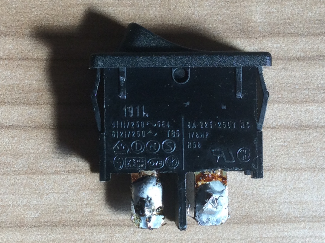

The switch from my A16:
Size is 22.6mm x 6.6mm with a kind of integrated plastic spring to keep it in position.
Anything with less than 23mm height and 6.5mm width will fit through the front panel slot.
It‘s a regular light bulb switch, nothing particular.
