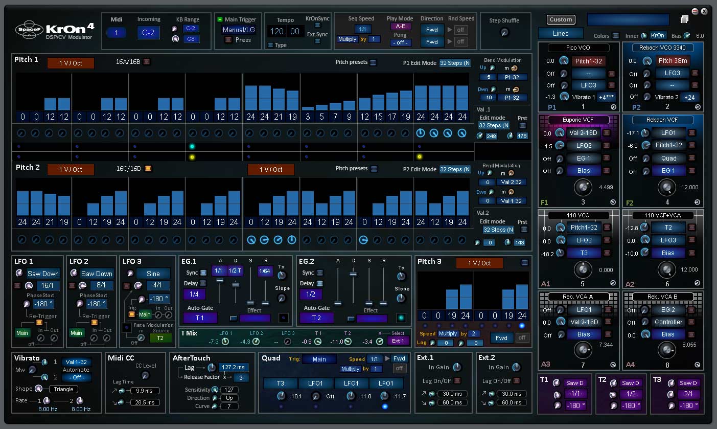

Ready for download
https://spacef-devices.com/sf-downloads/
New modulator "CV Tune 0" : allows to tune V/Oct oscillators without the need to sacrifice a step sequencer. The tuning is relative to Midi root key (Midi to CV device, or your midified synth or eurorack module).
Updated KrOn 4 (d)
- The EG1 sync mode was not reflecting sync time values right. Completely revised implementation. Presets remain Ok.
Various minor things here and there.
Additions:
- Added Ext2 input for the LFO fade-in/out triggers.
- CV Tune 0 modulator: allows to send a pitch of “+0” , which is useful to tune eurorack oscillators. This saves the need to sacrifice 1 step sequencer with all values at 0. You can find the CV Tune 0 modulator in the last mixer slot of each section (as well as in the first mixer slot of the P1/P2 outputs).
- Backward signal protection: a diode system (feedback modules) has been added to all outputs. This avoids signals going the wrong way in situation with a lot of interconnections between many devices (intense projects). The backward signal is supected to shut down all signal flows (ie outputs become unactive until the device or project is reloaded). This system – which is pretty light on DSP as it is just 8 feedback modules – forbids any signal to go back the wrong way.

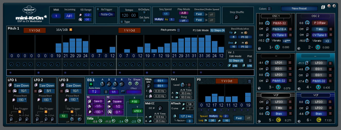

New KrOn 4 Mini
Perfect to control 2 synths ! Mini KrOn with 6 outputs (for example for controlling 2* VCo / 2* VCF / 2* VCA)
I also did this to make it more powerful in 96 Khz systems (6 outs better than 4). Let me know if all is fine in 96Khz samplerate.
This version updates KrOn 3 mini (KrOn3m.dev).
- EG 1 ADSR values were not easy to use. Revised Curves
- LFO 3 Fade-in / fade out values were wrong
- Output 2 slots were messed up (volumes and switch were not paired)
- P3 trigger of the EG1 has been revised and works properly (did not work because a CV Pitch of 0 is not "0" in scope, so it could not trigger anything (was always above 0). It was working only for DSP pitch). Now corrected.
- T2 inner volume was way below normal. Fixed.
- Minor graphic optimizations.
Main Additions
- Added Outputs 5 and 6
- CV Pitch 0 modulator. Allows to tune oscillators without needing to sacrifice a pitch sequencer.
- Added a 4th source to the T-Mix mixer.
- LFO 3 fade-in/out trigger sources, so a note-on is not needed to trigger the fade-in/out of the LFO.
- Color presets
- LG input to sync with LG sync pro or LogiQ.
Note
Since KrOn 3, KrOn and Mini Kron presets are not 100% compatible. For example, the 8 steps sequencers are particular to each device, and so will not be updated when loaded in another device. This is also the case for new parameters added since version 3, such as all the above parameters.
Other KrOn devices will follow (next weeks)...

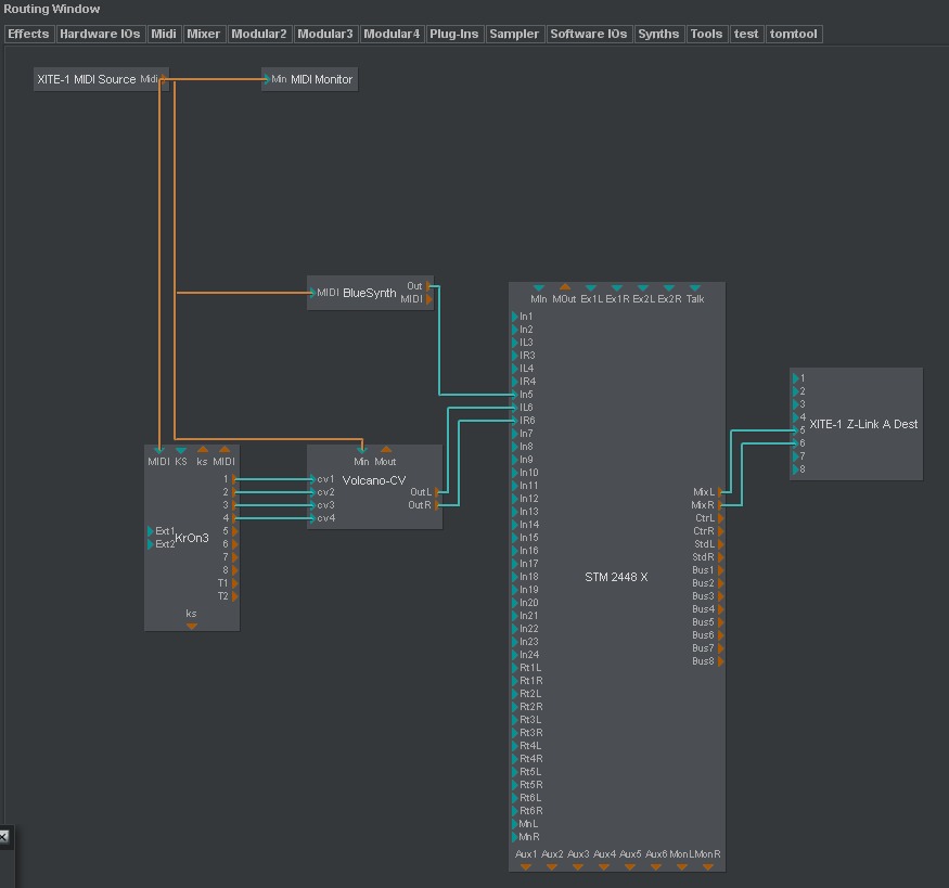

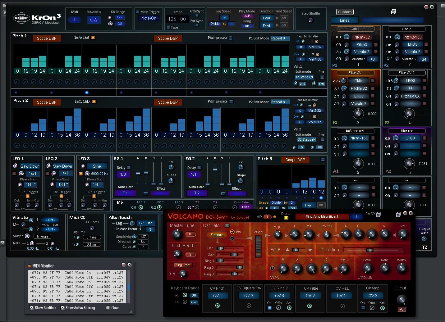

Sorry for my lame question, but:
I recently bought Kr0n and started playing with it.
I used Kr0n3 and some CV synth attached like the manual said.
I don't get any sound out of the synth unless I press "Drone", which is supposed to bypass the VCA.
What do I miss ?
What do I miss ?
Re: KrOn - CV/DSP modulator
mmh, not normal. Could you send me a pic of the project ?
I would like to see how everything is connected
I can try to reproduce the project to see what could be wrong.
or let me know which synth and I will make a project myself.
I suspect midi is not connected to the synth ? KrOn is a modulator and still needs a "root key" received by the synth, in order to modulate the pitch for example.

nebelfuerst
- Posts: 601
I'm pretty sure, it may be some lack of understanding on my side, being new to Kr0n.
Find attached screenshots and the project I used for testing.
- kr0ntestX.zip
- (500.81 KiB) Downloaded 579 times
- kr0n2.jpg (55.46 KiB) Viewed 25739 times
- kr0n1.jpg (396.5 KiB) Viewed 25739 times
Thanks,
I haven't noticed anything unusual in the pictures, so I will check this out tomorrow morning and hopefully, you should be all good by the afternoon/evening.
Ok so I tested and all works fine BUT it is probably an error in the download itself.
I will verify again and repack everything and upload it (and send it to you directly).
It should be ready before the evening (end of the afternoon)...
EDIT: I checked the zip and the files and all is fine and works "out of the box" without doing anything special.
I PMed you some ideas to check the midi or mixer.
Ok.. we found the bug... the midi channel was stuck to channel 1 even if the display showed another channel. I thought I corrected this years ago but apparently I did not....
Now Corrected !
