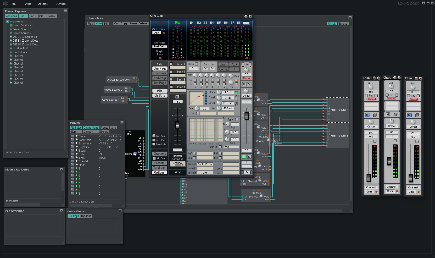

@yayajohn: My issue in not related to load. I can do wild dsp allocations without loosing sound within a project.
But on reload, the sound is gone and requires strange actions to get it back.
I just tried this in my project shown above:
Allocating the upper 4 channel elements and the upper Z-Dest to DSP8... everything works, sound is present.
Now I save and reload the project.. and there is no sound.
As the channel-elements show ampltiude, I tried all DSPs on the upper Z-Link Dest, but no way to get the sound back !
( The lower Z-Link Dest wasn't allocated to a certain DSP and works well.)
I also own the sdk, but I don't know where to look for DSP for an element.
- Clipboard01.jpg (291.22 KiB) Viewed 19016 times

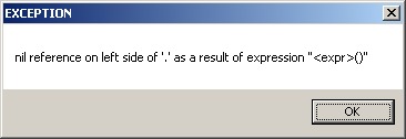

I tried to save the project from sdk to check for changes on reload, but it refused due to "illegal things" I made

also i am not sure if loading the scope project in the sdk is ok.
it isn't. you have to make sdk project
you will find the IO modules in the file browser window in the folder circuit design/IO
you can use the file browser or windows explorer to get scope devices in the sdk. you will have to fold them to properly app!y dsp assignations
Re: no sound after dsp assignment ?
now I remembered. you can't fold the IO modules. they will create the message prohibited action etc. you have to put an empty module from the circuit design folder and then drop the IO module inside.
then protect the module save it reload it and it should work
to make pads select a pad at the pad browser window and press e. An arrow will appear and there will be a new pad on the outer module.
do delete an exported pad reselect and repress e.
