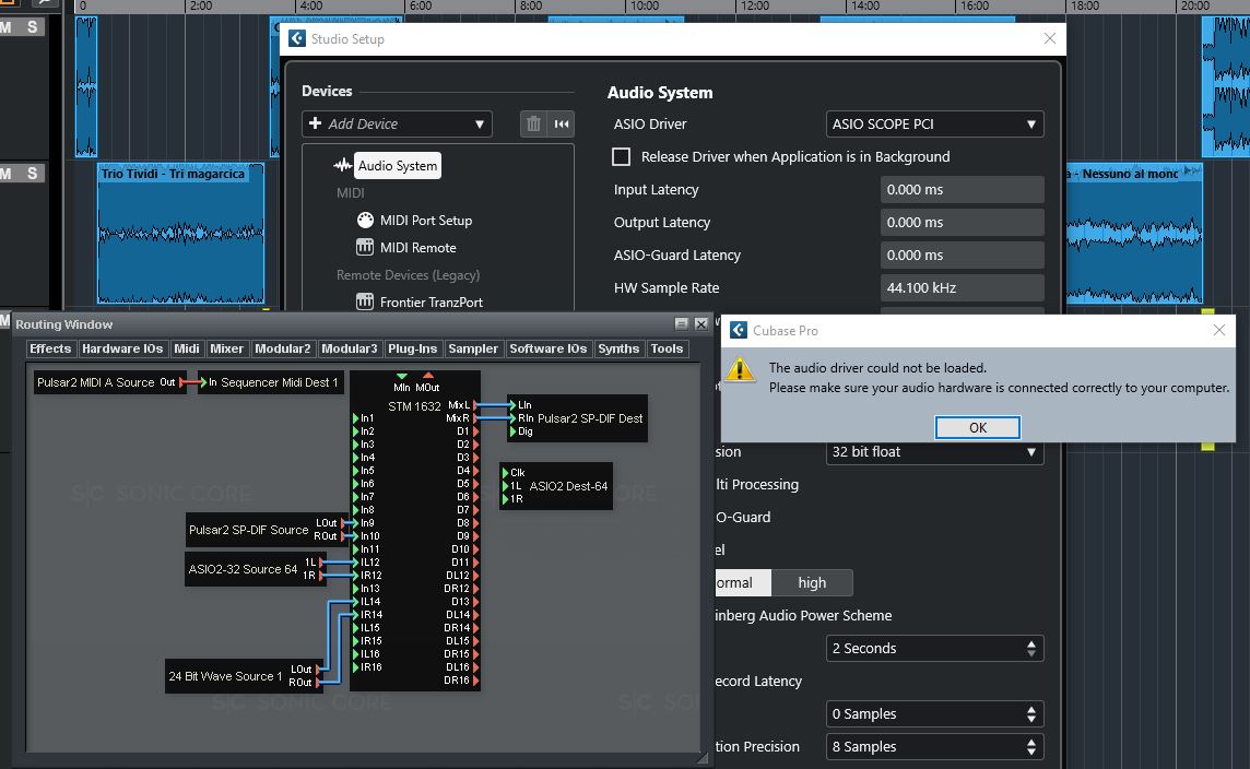

After 4-5 years, I finally changed all the capacitors on the Pulsar 2 card and installed it in the computer. Media Player works normally, but with Cubase I have an ERROR - ASIO drivers cannot be loaded.
Does anyone know what the problem is?

Which versions of scope, windows or cubase do you use ?

sandrob wrote: Thu Jun 06, 2024 11:47 am Does anyone know what the problem is?
from win10, you need scope7
Re: Problem with Pusar and Cubase
for Cubase, i would use either an ASIO2 source or an ASIO2 flt source and an ASIO2 dest.

nebelfuerst wrote: Fri Jun 07, 2024 9:04 am Which versions of scope, windows or cubase do you use ?
Scope v5.2709, Windows 10 and Cubase 13

Spielraum wrote: Sat Jun 08, 2024 4:56 am
Are you sure?
Version 5 worked fine for me with windows 10 before I changed the capacitors. Probably there was some error that I don't know how to solve.

garyb wrote: Sat Jun 08, 2024 8:42 am for Cubase, i would use either an ASIO2 source or an ASIO2 flt source and an ASIO2 dest.
I tried both combinations. Here I have attached a picture of the project that worked normally for me before the capacitors on the card were changed.
It seems that there was a hardware error... The only thing I don't understand is why multimedia drivers work and ASIO doesn't.
