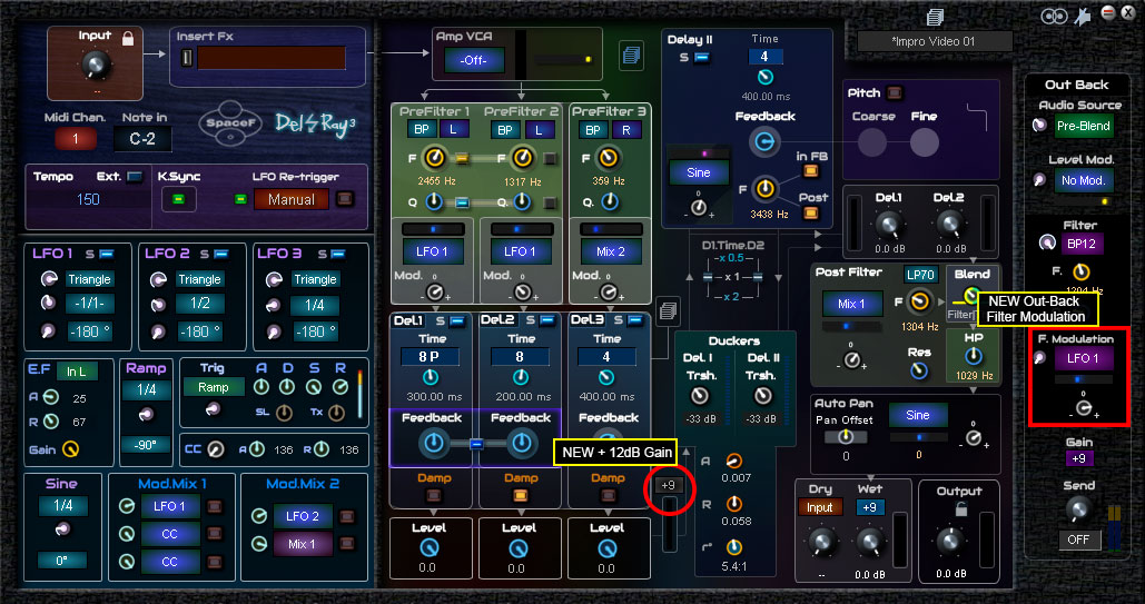

Del Ray v3 adds the following:
Out-Back Filter Modulation: makes it easier to test various filters, and effects.
Inner gain booster : a classic SpaceF gain booster, up to +12dB, by increments of 3dB.
The Inner Gain Booster is placed at the output of the "Tri-Delay" section, just before the compressor. You can boost and/or saturate the sound more easily, giving to the sound a more authentic sound, in particular when bass-medium are desired.
No Presets ? Please import your Del-Ray 2 preset list and resave it as a new "Del-Ray 3" preset list.
Older presets, which do not have the inner gain or new modulation parameters, will see these parameters set to default automatically (gain resets at +0dB, as well as the out-back F modulation amount).

- del-ray3.jpg (171.96 KiB) Viewed 51431 times

8 FEB 2025 : FULL REPACK or UPDATE
Sometimes, I forget the basics...
Del-Ray 3 and Dubby 4 updated with a MIDI output.
MIDI outputs allows to assign a CC number to a control, and record it to daw by manually moving the control.
- available as a full new install or update only
(update includes only the latest devices, so you do not risk overwiriting your presets).
only Dubby4 and Del-Ray3 have this new MIDI output....
As there is *no new parameter or drop-down menu*, overwriting the previous version should update the project (no need to reload the device in your projects).
>>> https://spacef-devices.com/dubby-del-ray-downloads/
