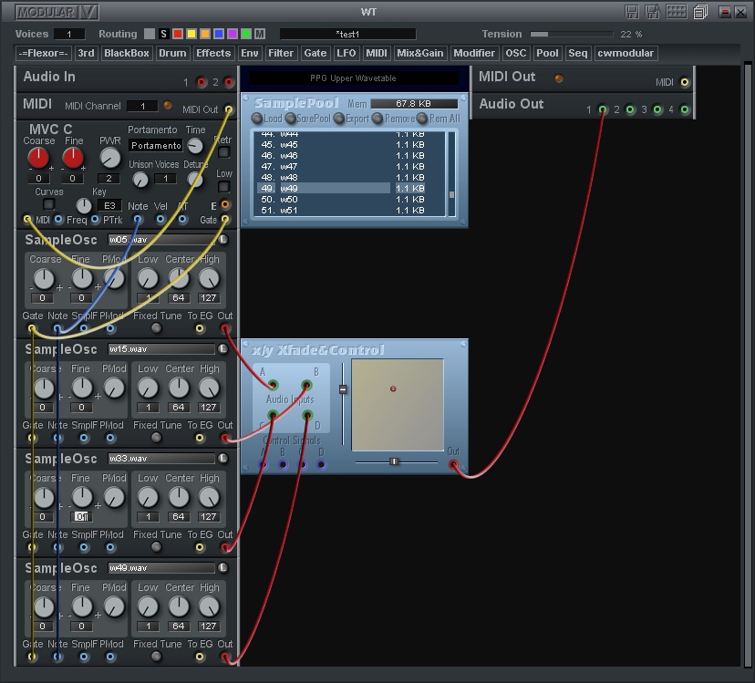

One more thing.... I just convinced my self that this illustrated simple setup shown below actually works with presets and all.... And opens a lot of possibilities for whatever you want to do from osc to output
Only fundamentals included, but insert whatever
Not quite the same but its getting closer. Added A PPG Upper Wavetable and the Virus Waves as well, as modular modules.

Re: Vectron Synth
your experiment there take it one step further take each sample osc to a filter then take the filter to a vca then that vca to another vca
do this for every one of the 4 voices then set the vector mod to the last vca of each voice channel then each voice channel to a paner
this will be much better as you now have transient based sounds being vector mixed

FWIW, due to the small DSP footprint and 16 voice presets changing instantly without loading too musch info, this is turning out to be an excellent Electric Piano with Circular Panning like a Rhodes could never do.
I finally had the time needed to push things forward a little and so far the Crystalline EPno's are awesome and very fresh.
