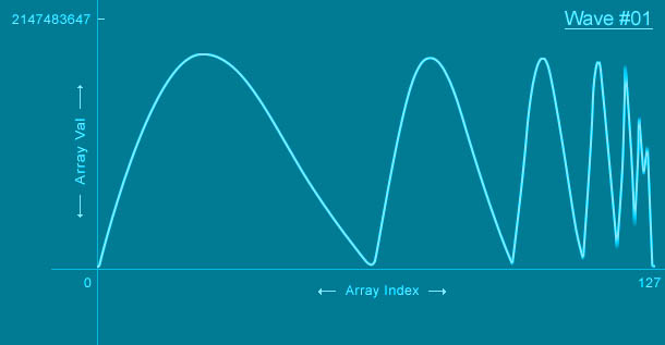

Shroomz~>
Posts: 5669
Location: The Blue Shadows
Post by Shroomz~> »
here's a visual representation of the first block of 128 from the Waldorf Osc's 1st wavetable (Wave #01). Each wavetable has 16 of these strung together to make up an array of 2048 with subtle differences between them creating the morph. This first block creates the first 4 of 64 morphing stages in Wave #01. Hope this helps. :cool:
HUROLURA
Posts: 1314
Location: FRANCE
Post by HUROLURA »
Quite Helpfull ... because really visual.
Thanks.
hifiboom
Posts: 2057
Location: Germany, Munich
Post by hifiboom »
thanks for the info, shroomz,
don`t know exactly but it looks like the stages seem to represent some kind of pitching also...
not sure about this....
theoretically if i read through a wav file specification I could build some sort of wav to waldorf wavetable converting tool by programming a little tool.
but the question is : do we really want this? the waldorf oscillator is some sort of digital sounding oscillator and due to the small amount of samples per waveset it has inferior quality also intentionally like the original stuff sound digital also.
btw how did you visualize the array in that nice way?
I`m also working on a phase distortion waveshaper that can change the sound of an basic oscillator (sin, saw, tri) in drastical ways, still keeping the quality high.
My major plan with all this wav shaping and wav based oscillator stuff is, that it should give new sound options with out affecting the sound quality.
The Flexor draw waveshaper is a good approach, but its still not yet fixed regarding the jump point and so it delivers non-perfect results.

Shroomz~>
Posts: 5669
Post by Shroomz~> »
hifiboom wrote:don`t know exactly but it looks like the stages seem to represent some kind of pitching also...
If you look at the image I posted above... well the Waldorf osc uses the first 64 samples of the 128 block for the bottom 4 of it's pitch octaves, which is interesting to say the least.

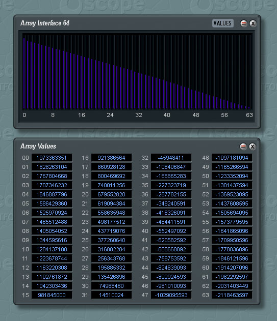

sharc
Posts: 638
Post by sharc »
Coming Soon ...
...to an SDK near you :)
Also works nice for realtime wavetable creation.

Post by Shroomz~> »
Been trying out this array draw tool today. We've got it connected directly to the wavetable input of the Waldorf Osc, so it's now a wave draw Waldorf Osc. Seems a little unstable at times but it sounds completely insane. :D
hifiboom
Posts: 2057
Post by hifiboom »
lol, great sharc and shroomz, looks very nice.
A different sound is always an additional value+++
