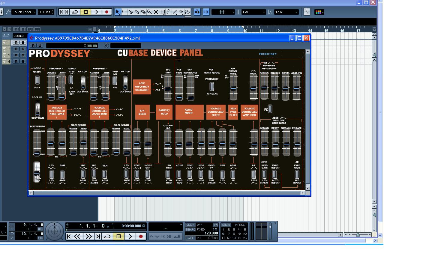

Your Cubase sounds broken. I am using Cubase 4 (full version) on Windows XP Professional and Home (2 different pc's). I can import bitmaps as attached (I used Cubase for this and not an xml editor)
Regardless the bitmaps adds nothing to functionality. all I want is a device panel for my prodyssey. Adding pretty pictures afterwards would be icing on the cake, but I just want a cake so I can use my Prodyssey. Standard Black is a pain to read so, whiteface (or grey) is even better!
I will try and get some time to start writing one of these. If you have a starting position then please send the source to me. I am familiar with xml so could also edit via dreamweaver if I subsequentley found the Cubase editor cumbersome.
Please note you will also need the attached jpg in "my documents\my pictures".

Project Summary
I have started. The part that is taking me the longest is the bitmap with all the wording, colouring, saw, square maps etc. However now that I am geting to grips with Image layers it is easier as I can move things around. The bitmaps function is working flawlessly with jpg, I have not tried the bitmap yet, so maybe it does not work...........
Does anyone have a transparent image for the square wave, sine wave, adsr, sawtooth etc I can use for this panel?
I will put in the normal panel without the additional panel (eg effects, aftertouch etc). But will also add an Effects Bypass switch. When I am finished I will also post the layered image so that others can tinker etc and allow you to change colours as I have opted for a grey background as it is easier to read than the black metal of the Creamware editor (which I find VERY hard to read - the writing seems blurred even with my glasses on).
I will not be able to put full patches in etc (not enough time and I am too thick), but it will allow midi automation etc from Cubase and all is going well. Hopefully my starter will then be refined and ultimatily finished by others who can put on other bells and whistles until we have the all singing/dancing version
ETA - For the first posting of Prodyssey Cubase Device Panel 24th January 2007 23:00pm.

OK, so finished the inital gubbins for the Prodyssey.
Yes there are problems, but unlike others I will share what these are......so we do not waste others time.
1) Although I switch on the R and W for automation,the midi from cubase does not automate the controls on the device panel on play. But hey, you switch on the creamware editor and you an watch that move. bizzare!!! It does actually send to the asb/klang so it is just superficial!
2) I have no idea whatsoever on how to get the presets into the device panel other than manual.
3) I need a way of getting snapshots of the device into the panel.Any clues?
Apart from that, it works a treat and allows you to control everything from cubase without having use up resources using the creamware editor, and all encapsulated from cubase.
I need others to help me with putting the patches etc in.This has taken a VERY long time, so would appreciate help from others there.
I have done my bit, now if someone can help me finalise it I will start on the PRO-12. If not then nothing will get done and I will change my name to Andre!!!
