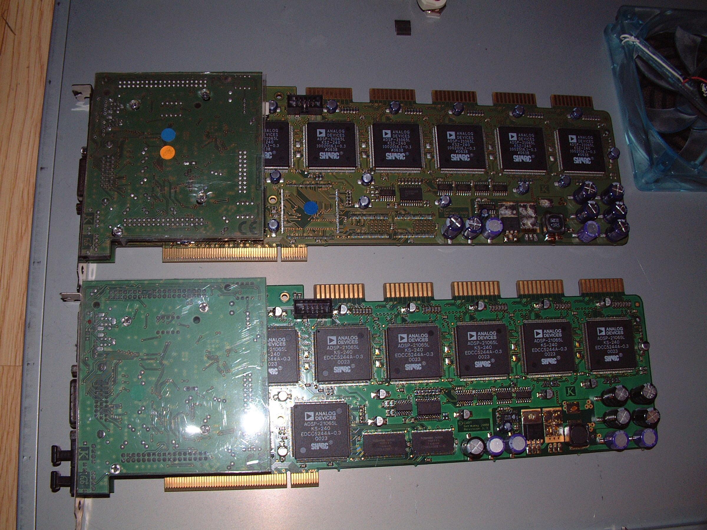

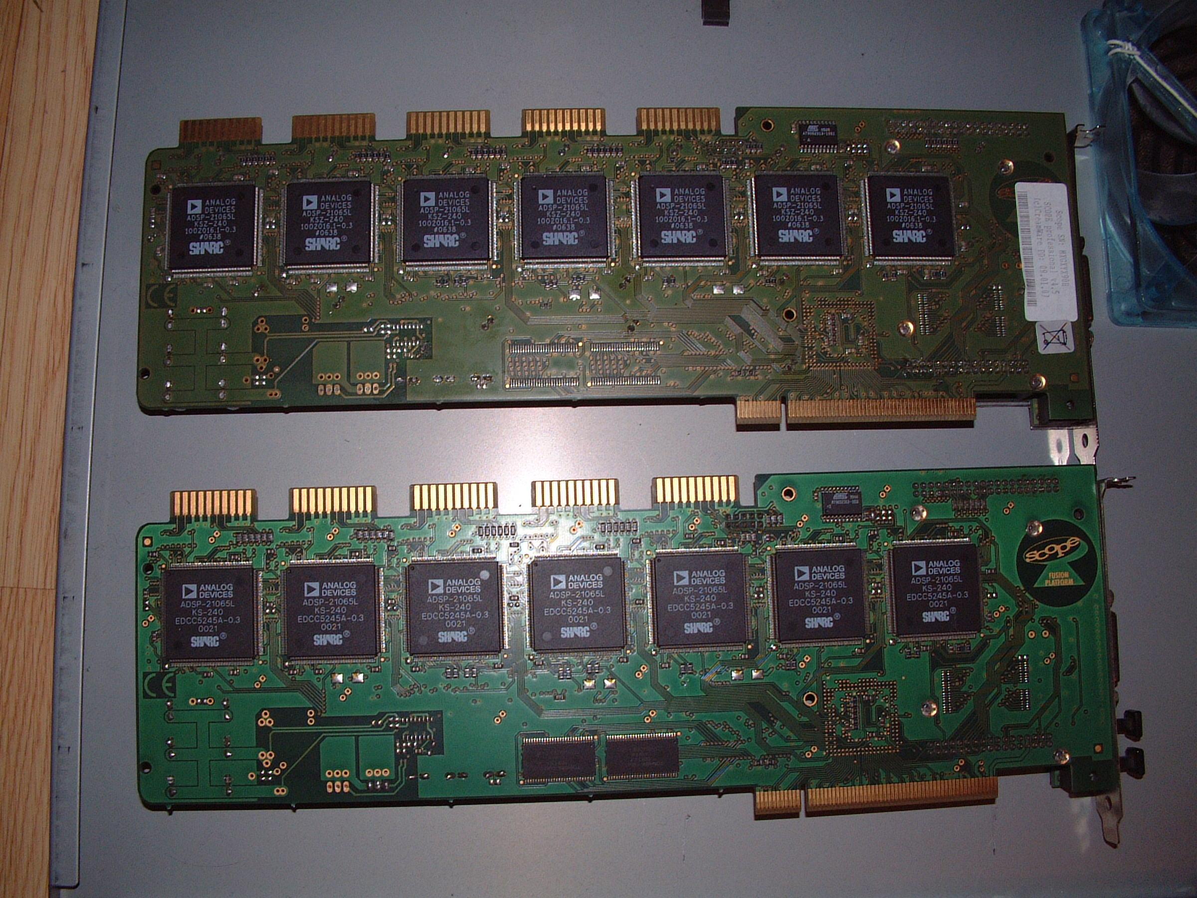

What could be nice is to get screenshot (both sides) of both 14-dsp and 15-dsp so we can see the different. I have asked google for such, but he is not giving me any proper picture of 2gen card on the back! :)
Rgs
Egil

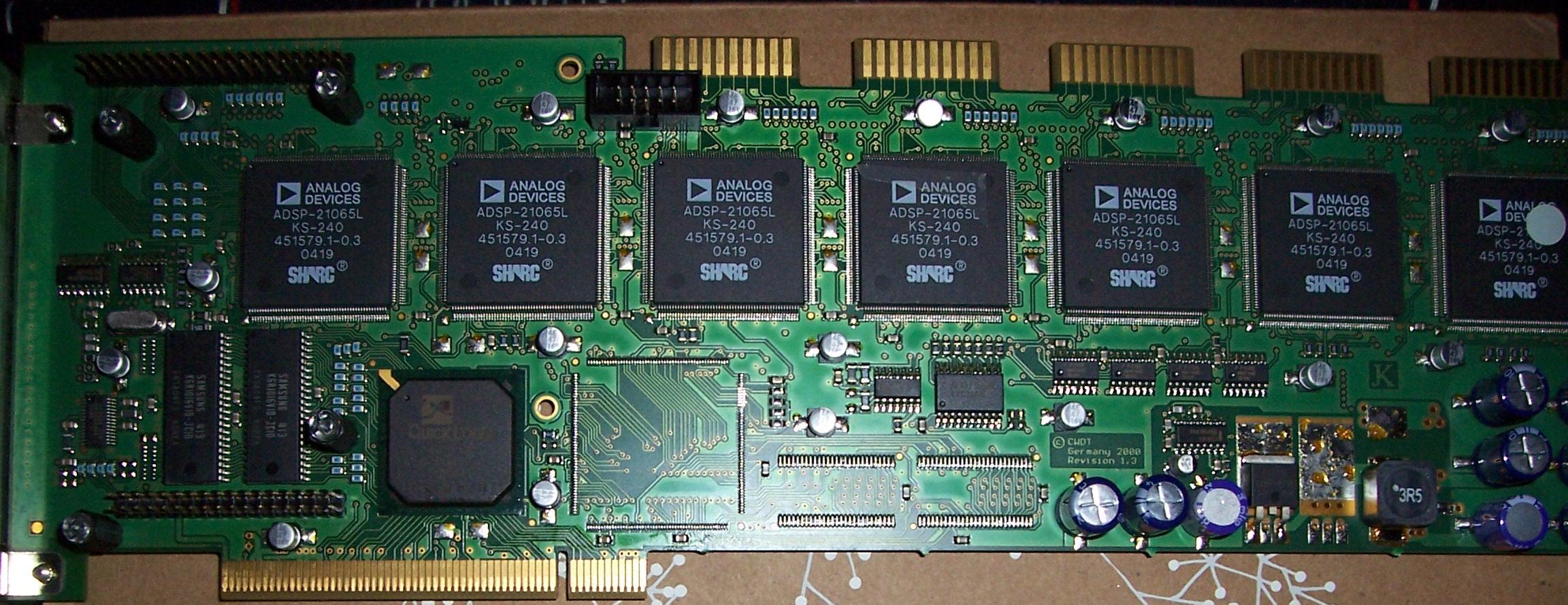

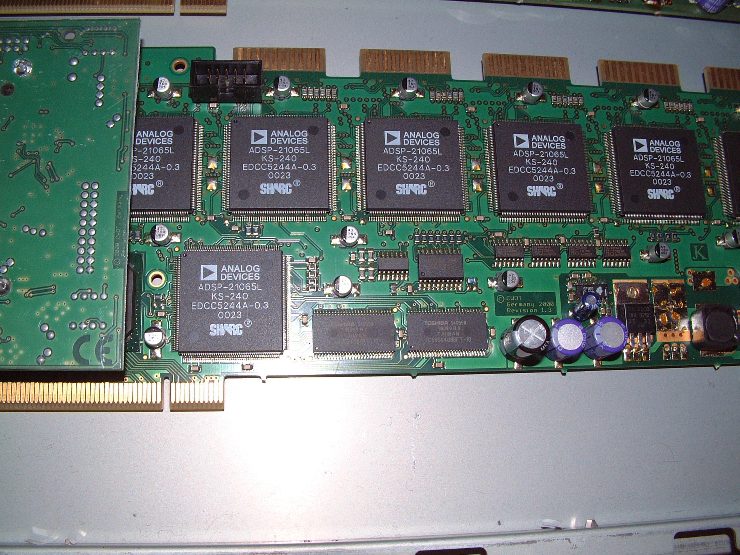

Difference is easy to spot.Missing dsp on the upper side of the card.

Thanks a lot!! that means basically all picture out on google is actually the 1.gen card.. even its adds. for 2.gen :D
Now i know that i am about to get a 1.gen card :P

I have both version, they look identical, but the 15 DSP card have 1 extra DSP chip and 2xram on both side.
