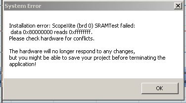

hi all,
after 3 hours things got even worse ...
- did a cleanup of old registry entries for scope pci entries = didn't help
- unchecked every power saving setting I cound gain = didn't help
... sope software started but after playing back some tracks in cubase ... copy violation ...
- did a fresh installation with downloaded version of scope xite-software ... copy violation
... then some new errors occured: dsp1 could not load satellites ... no gain to hardware ... hw 30 detected and so on ... communcation error ...
so now I turned off everything because I dind't even have success starting the scope software ...
will do a last testing tomorrow with another hdmi cable ... if that doesn't work xite will be returned. we will ask sc support if they can check the unit ...
will tell ya tomorrow what happend ...
good night
tom

- xite_err03.JPG (33.92 KiB) Viewed 4253 times
- xite_err02.JPG (23.86 KiB) Viewed 4253 times
- xite_err01.JPG (15.61 KiB) Viewed 4253 times

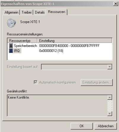

Re: HELP! XITE communication error
hi,
- only 2 pci-express slots for that kind a card on the mobo and 1 is covered by the graphics card - so I can see no option to use another slot
- I noticed that one time, the power led of xite unit switched off when the copy violation error occured. thought this is it but afterwards the error occured but the power led was ok.
- this evening I will try to use another hdmi cable
- if the error still occurs I probably give it a try on my own machine (just afraid of messing up my machine when installing scope drivers/software )
cheers
tom
cheers
tom
