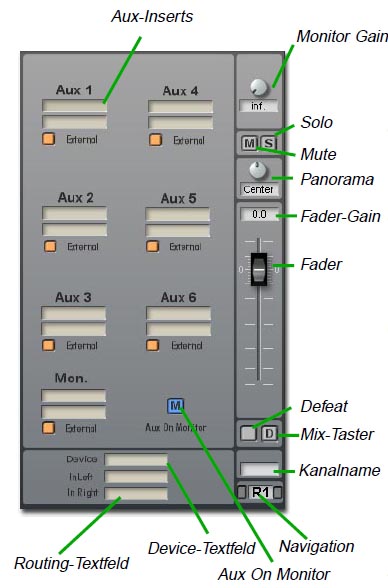

Do you have the SC Plate X loaded as an insert in a STM Mixer? If so, get rid of it and use it outside the STM. Had similar issues with large devices, especially reverbs/plates. The given workaround worked well for me...

reverbs usually don't need to be in inserts anyway.
Re: verb error jpg
sorry, I wasn't clear. I meant the AUX inserts of course, there you have the possibility to load the plate inside the STM or use the External button to route it outside the mixer... this is common, isn't it?

that's right, it's not a disadvantage to have the auxes routed externally.

The reverb is outside. I don't have much trouble with STW verbs, I just try to know why sometimes I get error message (which disappears by assigning it to a dsp) and if they need a dsp allocation.
I like the STM mixer. The only bad thing is the aux. which are mono. If you want a stereo aux, you need to use two of them, so there is only 3 stereo aux. And you cannot assign same CC controler to the both aux send knob (left & right) or you'll need something like Spacef CC5 for each channel / aux you want to automate (not sure about this last word...) ; at the end, the project window is full of CC5 !
