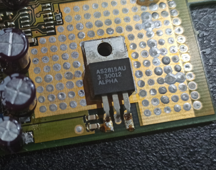

The part of the voltage regulator is the black quare part with I*R 3103S labeled on it.. on my scope card, so I suppose pulser2 is the same.
You can buy them from aliexpress and you need some soldering skills to remove it.
For a pulsar2 the price in germany is in the order of 200 Euros, so there is a natural limit for repairs.

The only thing that looks like a transistor to me is this. The specifications say that it is a "voltage regulator".
nebelfuerst
Posts: 601
Re: A communication error with Pulsar2 (brd 0) has occured.
Post by nebelfuerst »
Yes. You're right, this is the one for a P2.

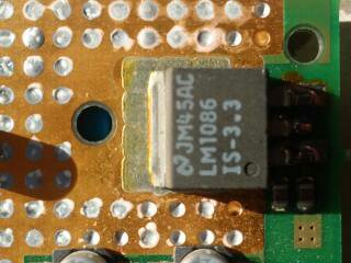

I had a look at my cards, so here are the mosfet for P2, Luna and scope.
For P2, the datasheet can be found here.
https://www.digchip.com/datasheets/part ... AU-pdf.php
Looks like they used different schematics for voltage regulation.
The easiest way is to buy exactly the same part. otherwise you'd have to do some datasheet research..
