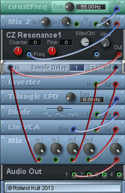

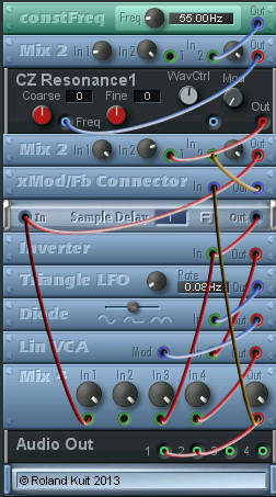

I have a question here.
The Flexor sample delay module seems to work different from the one in the NMG2.
How come?

Allpass test 1:
Flexor Allpass mod.rar
(421.86 KiB) Downloaded 129 times
Roland Kuit Flexor Allpass mod.jpg (33.34 KiB) Viewed 2268 times

Flexor Allpass test 2:
Flexor Allpass mod 2.rar
(407.8 KiB) Downloaded 113 times
Roland Kuit Flexor Allpass mod 2.jpg (38.16 KiB) Viewed 2268 times

I think "technically" a sample delay is the same as a feedback module, but in reality they're not? Tgsgs might have a better understanding.
