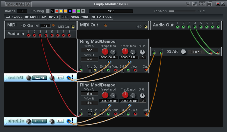

I am using RingMod, Diodes and other waveshaping modules trying to get the perfect sound of the Leslie Tube Pre Amp as we speak.
We have a decent Rotary already in Scope, it's the Digital Distortion thats tough to get an equal effect up and down the keyboard with.
I am still using this for my B2003 until something better comes along.
Re: NSA on the internet is looking better and more trustwort
Posted: Sat Aug 31, 2013 9:17 am
Here's just a hit and miss try using these 2 modules and 2 x inputs of the B2003s signal.
Odd that the sound gets thrown around like a rotary effect, but the clipping is uncontrollable for a newbie like me.

jimmy if you are getting clipping try using level controls for the b2003 before hitting the ringmods as the signal might be to hot from the b2003 outputs
and see if you can reduce remove clipping
dante its nice that you can control rotary fx by mod wheel but the original equipment never had it so to achieve the correct type sound you have to emulate
the original frequency of the rotor 2 speeds fast and slow
Posted: Sat Aug 31, 2013 2:09 pm
by jhulk
also jimmy because the rotary fx makes the mono b3 into a stereo signal try and just have 1 audio input
from b2003 and have that go to a panning module and have its mod input with a switch with 2 lfo with different speeds
then have it goto the ringmods
when i get back ill have a play with it and see what i can come up with
