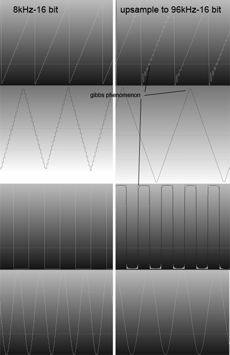

I made a small graph about up-sampling.
- upsampling.jpg (145.71 KiB) Viewed 10941 times
Also you may found interesting that article
http://en.wikipedia.org/wiki/Ringing_artifacts
				Re: scope waldorf oscillator now in hardware modular module
				Posted: Thu Jan 22, 2015 4:22 pm
				by jksuperstar
				This thread has great information.
Thanks for showing the shortcomings of upsampling, it's true, and unfortunate at the same time.  And probably points out my "desire" for various modules to run at various rates, was really a desire to have the best of each module has to offer (running filters at higher rates, etc)....but even then there are negatives.

				i totally agree with you about the upsampling fra77z
i never disputed that
and why i always down sample
many designers have tried to get the 12bit sound ni have a s950 and sp1200 sound 12bit emulation but it does not sound the same
when comparing
the problem is its not just the dacs but all the components used crosstalk temp that can change the sounds
the problem with dsp  is unless you model each component and create exact circuit emulations you are not going to get the sound
as for me the sts osc can play 16bit samples well and at any frequency playback rate that the sample was saved at  if you want grunge sample at 8bits save as 16bits linear and you will have 8 bits data in a 16bit file padded by 0
so for a full 256 8bit sample it would be 11111111 in a padded 16bit file it would be 1111111100000000 same data this would be for a single cycle period of a sound now the frequency rate would be frequency range by seconds so for a 12khz sample for 1 second x 8bits would give you 12000 8 bit results for one second of sound
as there was never a 12bit program for saving as a 12bit audio file it was actually done in 16bits on a mac and sd2 and then dumped to the sds12bit standard unless you recorded via the 12 bic adc
when you convert a emax or eii 12bit file you always get a 16bit file 12bit dat padded by zeros
so a full 4096 sample 111111111111 and a 16bit version would be 1111111111110000 still 12bits data in a 16bit file
if you want a 12bit sound just do bit reduction this will add distortion but many people call it crunch and on high frequency sounds like the snares and hats the lower the frequency rates the less smooth the sample calculations between the points
now the problem with looking at waveforms on a computer is they look steppy but they are not its just how they are represented in the computer as lots of tests were done with these steppy waves from a computer when rendered to analog by the dac on shown on a scope there was no steps in the waveform
up sampling does cause ringing but that ringing is usually brickwall filtered out
