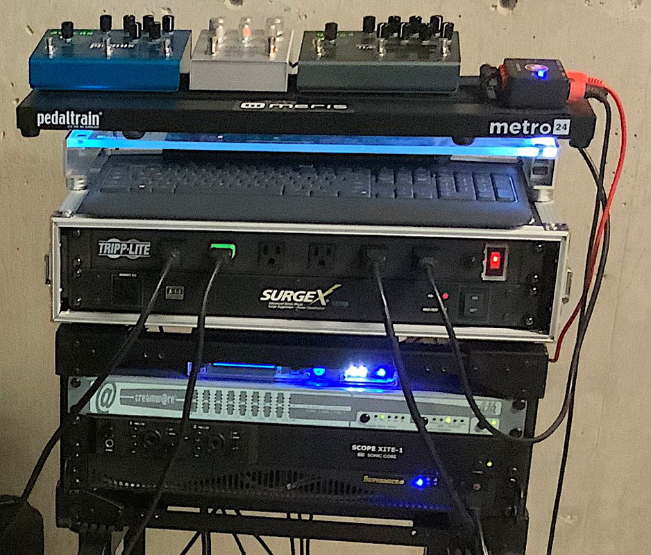

If gear is running on different outlets in the room, or worse yet different circuits with different outlets, you may have a ground difference that can cause several problems. One is that you may get some small (millivolts, but measurable) when AC flows across the circuit from positive to neutral. The second is that noise which can normally be filtered out has a phase shift across both outlets, leading to very bizarre forms of noise.
Second is just 'bad ground'. Ground lift switches can help compensate for this, and when I face that issue I prefer Hum-X/EBtech style products that go either on the power side or on the audio cables (when necessary). I carry this stuff in my gig bag as well btw, in addition to having rack power units and floor units that compensate for voltage dips, filter the power (noise removal via filters) and can help identify when there's a ground issue.
With this latter case, I had to run my own ground stake 2 homes ago to remove ground problems, and things worked considerably better.
There's a thread here somewhere where we discussed not just the products I linked above (easily searchable) but also ways to deal with ground noise on analog cable runs (where to break ground and why).
The last concern would be the PSU in the computer itself. Not all PSU's are of equal build, even when they have the same end-brand name on the unit. I use http://www.jonnyguru.com/ forums (and a few others) to try to research the exact factory that my units are coming from, and then when I have issues I check for voltage issues and ripple noise. Note that HWMonitor (Pro & Non-Pro) and other simple utilities often completely misreport voltages, so I rely on paid tools like AIDA64.
Hopefully you either have or will eliminate such culprits before having to send the unit in, just to save time & $ if possible. Best of luck!

Thank you for chiming in! That was my goal for posting here, to eliminate all possibilities before sending it back to Holger.
All my equipment runs on the same circuit, but different outlets. Not all equipment is grounded, but what can easily be grounded is grounded. Might be an avenue to investigate before involving Holger in this.
This is the second apartment that I experience this problem in, so the pixie moved with me from the old place - along with other stuff, but that is off topic...
Also, I don't experience any static electricity, not small shocks or anything, but I can't completely rule this possibility out.
Still though, when I experienced the problem last. All power was gone from the unit for several seconds. No light in the power led, and I had to actively push the power button several times before it came back. Which makes me think it is internal in the unit (having ruled out the power supplies). I think it is either a bad capacitor, an internal lose connection or bad soldering point.
