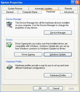

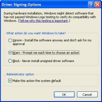

Posts: 2929
Re: NOAH Screen scrambled
MrV wrote: Sat Feb 03, 2024 6:18 am ....seems like something in XP is blocking 3rd party driver insts.
Could that be it?
You mentioned something about the equivalent of Driver Signing?
Windows Firewall maybe ?!
I mentioned it earlier already (see above) ...
set to "ignore" and make it "system default".
Reboot and install the Noah remote Editor software v1.1.
Finally you should have working USB, MIDI, WAVE and ASIO drivers and can use it for playback of media players.

Post by MrV »
Hi Budweiser ,
Noah is set to Windows
I set XP Driver Signing to "Ignore" , set as Default , Rebooted and tried again .
XP finds the Noah . I selected "Install From Removable Media"
I can then see/hear the CDR searching the Noah disc.
But I'm still getting "The wizard cannot find...."
Should I install the Noah software first and get back to this later instead ?.
M
