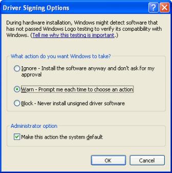

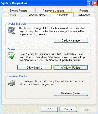

I mentioned it earlier already (see above) ...
- system-properties-hardware.jpg (32.29 KiB) Viewed 28593 times
- driver-signing-options.jpg (21.31 KiB) Viewed 28593 times
set to "ignore" and make it  "system default".
Reboot and install the Noah remote Editor software v1.1.
Finally you should have working USB, MIDI, WAVE and ASIO drivers and can use it for playback of media players.
ASIO works too, but because of age it´s not as good as today´s ASIO drivers,- RME or such.
When I used Win XP for Scope, I had to do also for Scope v5.1
I hope that helps and will work for you.

				You will have to do this for most things now, the certificates in WinXP will have expired for most signing purposes.

				Hi Budweiser ,
Noah is set to Windows
I set XP Driver Signing to "Ignore" , set as Default , Rebooted and tried again .
XP finds the Noah . I selected "Install From Removable Media"
I can then see/hear  the CDR searching the Noah disc.
But I'm still getting "The wizard cannot find...."
Should I install the Noah software first and get back to this later instead ?.
