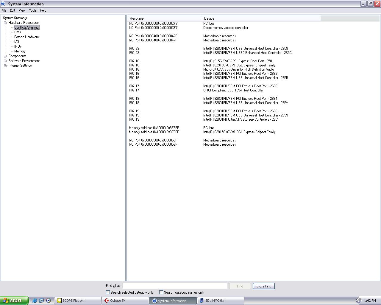

heres another screenshot of sharing,irqs. pci express slot is occuied by the 8800gt graphcs card, which i also tryed removed and got the same pci bandwith results.also checked about the motherboard and its a oem sony motherboard specifically designed for sony; not on intels website and no manual anywhere to be found.

Re: Masterverb Test Thread
everything looks good.
how about the video card...did you disable accelleration?
for info, my 15 mverbs on 9 DSP was on a system with a 8800gts. I suspect there MIGHT be BIOS/motherboard driver trouble..
yes, that would be a good place to start....
