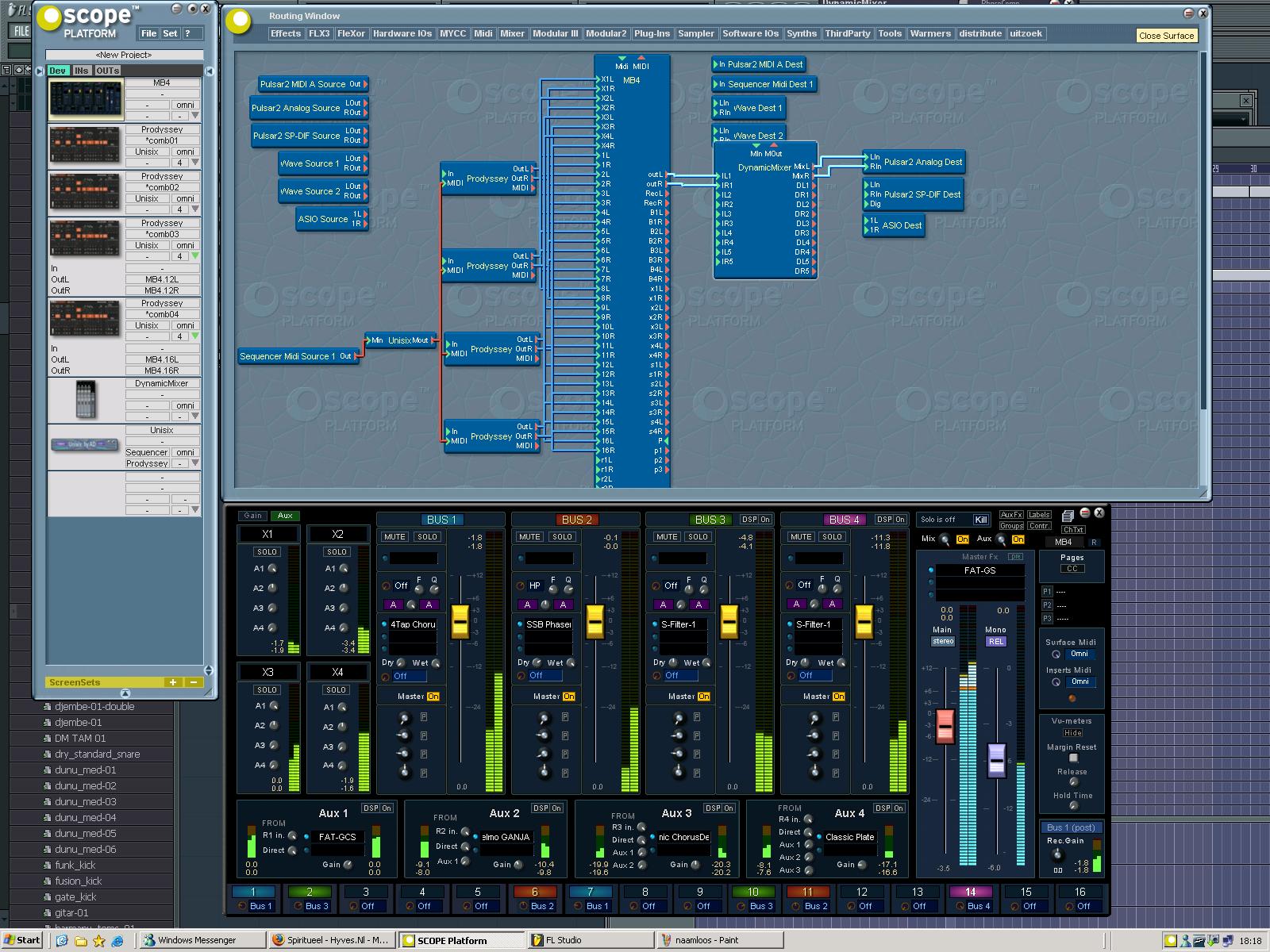

Tonight at home I figured I would try this! Perhaps 4x prodessey
is a bit overkill :P
So I route the normal prodessey outputs to X inputs. Then each prodessey have 4 inputs which can be routed to one of the 4 busses.
Medhi: when using it for such weird (?) routing, input gain/panning would rock (of course). Now I Am thinking to put a micro mixer before the 16 inputs so I can do that.
ALSO: can someone confirm you can only solo ONE bus ? if I solo two the sound stops.
spacef
Posts: 3354
Post by spacef »
pretty picture :lol:
The MB4D, with 4 bus send and invidual panning (per aux send) is on the way. Still in the test tube though, then released as a seperate components.
The MB4-G pitcured above (g for groups) is a bit lighter, and given for free with FB5 or FP mixers.
