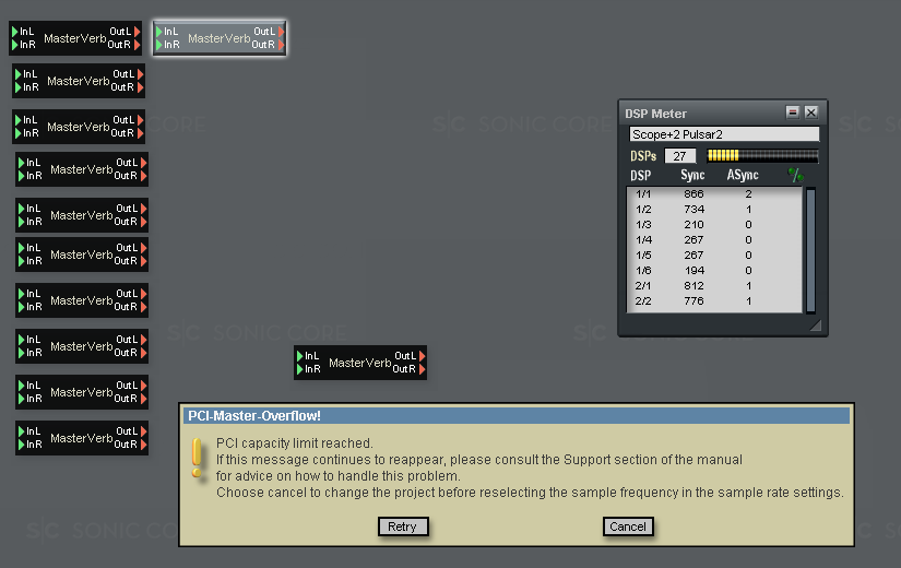

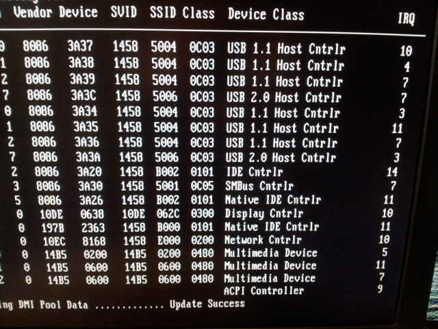

Re: Masterverb Test Thread
Hey, there!
Just want to post my results, before I move to the new board. The system isn't optimized mutch. See IRQ table... Also not shure, that the test was set right... May too empty environment?
1)Motherboard, CPU and RAM
GIGABYTE GA-EP31-DS3L, Intel Core2Duo E8400 / 65W, 4GB (PC2-6400) @ WinXP SP3
2)CWA cards installed and eventual other PCI cards.
2x Pulsar2 + 1 Scope (Scope is wrong placed - an the edge of Mobo, max. distance away from the graphic card), no other PCI cards; Connected via two STDM cables
3)Graphic Card used
NVIDIA GeForce 8500 GT, 256 Mb DDR2
4)Number of Masterverbs loaded in an empty environment before PCI overflow is reached.
12, the at 13th the Overload message appears...

- Empty Scope with ~13 MasterVerbs...
- 2xPulsar_1xScope.JPG (107.32 KiB) Viewed 48826 times
- BIOS report...
- Gigabyte_ea35.jpg (81.22 KiB) Viewed 48826 times

3)Graphic Card used
NVIDIA FX 1800 8500 GT, 768 Mb DDR3, with a fan
Also the same results as with my old board (GIGABYTE GA-EP31-DS3L, Intel Core2Duo E8400 / 65W, 4GB (PC2-6400) @ WinXP SP3)
- 27 DSPs: 2x Pulsar2 + 1 Scope
- New_GIGA.JPG (96.45 KiB) Viewed 48791 times
- IRQs GIGABYTE_GA-EP45-UD3R
- New_GIGA_IMG_20161024_092354.jpg (227.55 KiB) Viewed 48791 times
