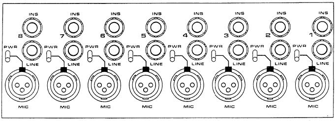

On the 200 series (8-4-2 version), channels 1-8 on the rear look like this -
the power switches are the phantom power on/off for each channel, but I've got no idea which way is which atm.
Posts: 23395
Re: Allen & Heath MixWizard WZ3:16:2 - anyone used these desks?
i'd say "on" is up, with the switch towards "pwr".
the easy way to tell would be to plug a condensor mic in and check for level in the meters with the switch in both positions...

garyb wrote:i'd say "on" is up, with the switch towards "pwr".
That's what I think myself as well. Seems logical.
