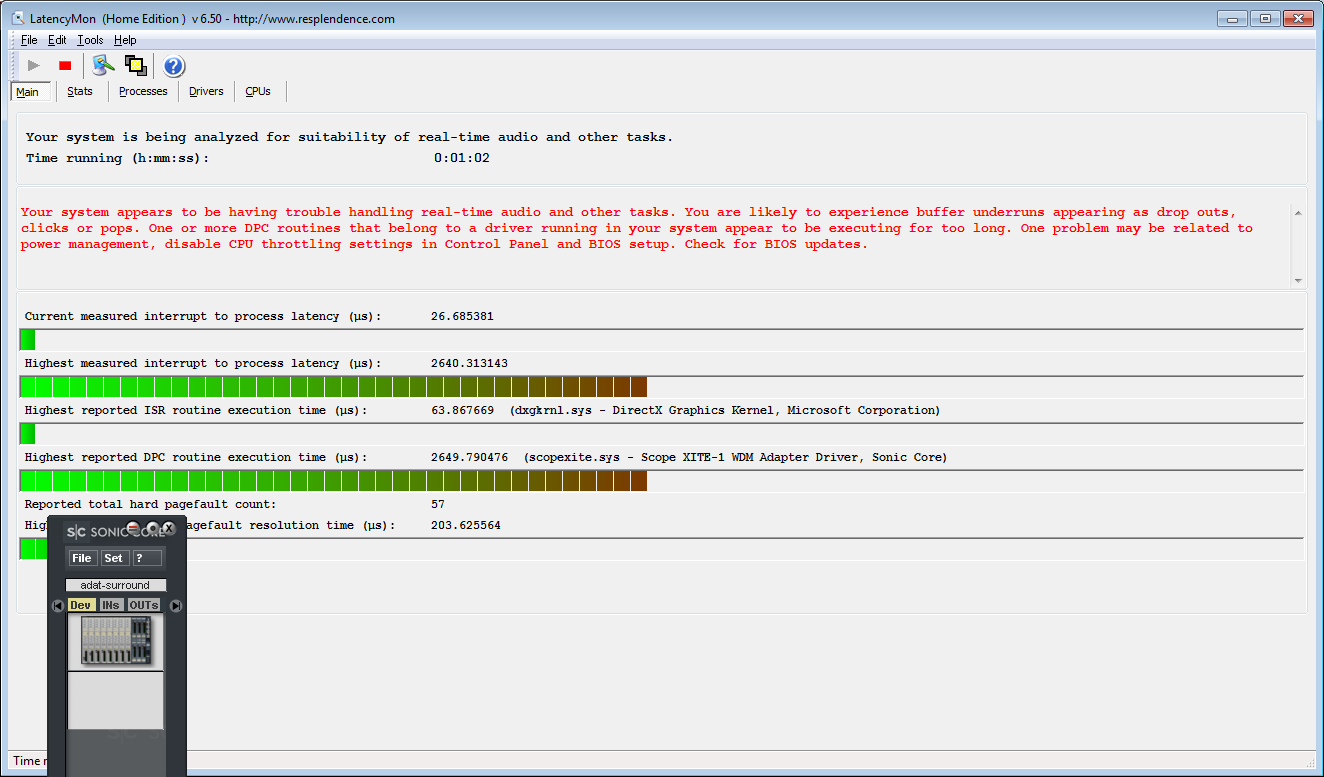

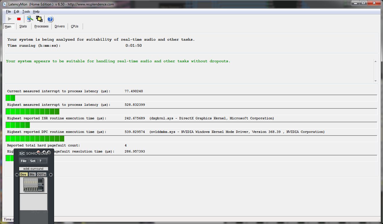

Testing using LatencyMon. A16 connected to ADAT-A:
And here connected with ADAT-B:
The troublemaker seems to be scopexite.sys!

Hmmmm.... re-install Scope drivers? Check for duplicate Scope files? Don't see this being done in the thread.
