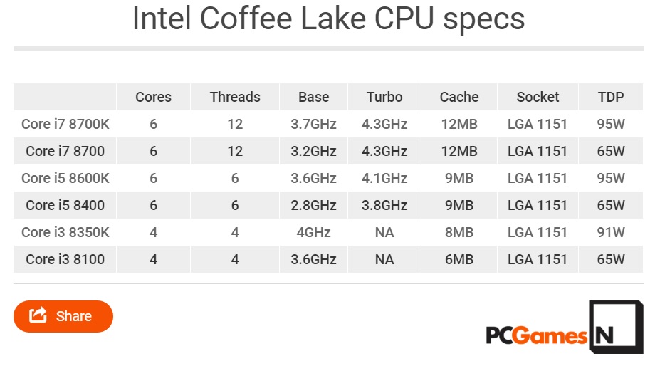

If 1151 wont work, then is it the case we miss out on Coffee lake i7 - 6 core (RRP $349) for XITE ?
coffee-lake
coffee-lake
pic from https://www.pcgamesn.com/intel/intel-14 ... lease-date
Re: Is there any such Motherboard that ....
maybe, or maybe there will be other changes.
it's hard to say at this point.
