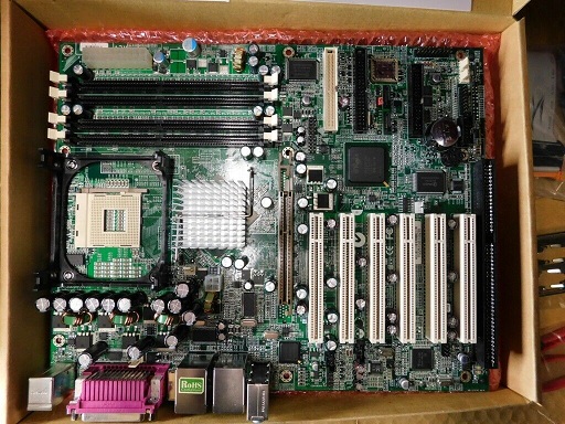

Just built another XP machine to run scope and it's been amazing.
BCMCOM Motherboard, Socket 478
P4 3.0
500 watt PSU
4 GB ram
GeForce FX6200
240 GB SSD
Been running great for past week, and I just added another Pulsar card. 8 DSP's of fun, no complaints.
Also, those motherboards are available still, NEW, motherboard/CPU combo. I found a seller on ebay and it was $120.
It has:
1 AGP
6 PCI
1 ISA
The ISA and 6th PCI are shared.
P4 3.0
500 watt PSU
4 GB ram
GeForce FX6200
240 GB SSD
It has:
1 AGP
6 PCI
1 ISA
Re: Definitive Scope PCI card host PC?
Nice looking board.
absolutely - didn‘t know there were P4 boards with ISA slots... so thank you @PlanetZaxxon .
Just browsed the manual and it seems a better alternative than the old Asus P2/P3 boards on my target list to eventually get the HardSID Quattro (ISA) up and running. It’s been sleeping for ages in it‘s box on the shelf.

Link ?PlanetZaxxon wrote: Tue Mar 23, 2021 4:43 am
Which RAM does it support ? RAMbus ?
- PlanetZaxxon
- Posts: 41
- Joined: Sat Mar 06, 2021 7:29 pm
It is the standard SDRAM, DDR400. 1GB max per slot.
Just shoot an offer for $120 and he will accept.
https://www.ebay.com/itm/NEW-Intel-Sock ... 2749.l2649
