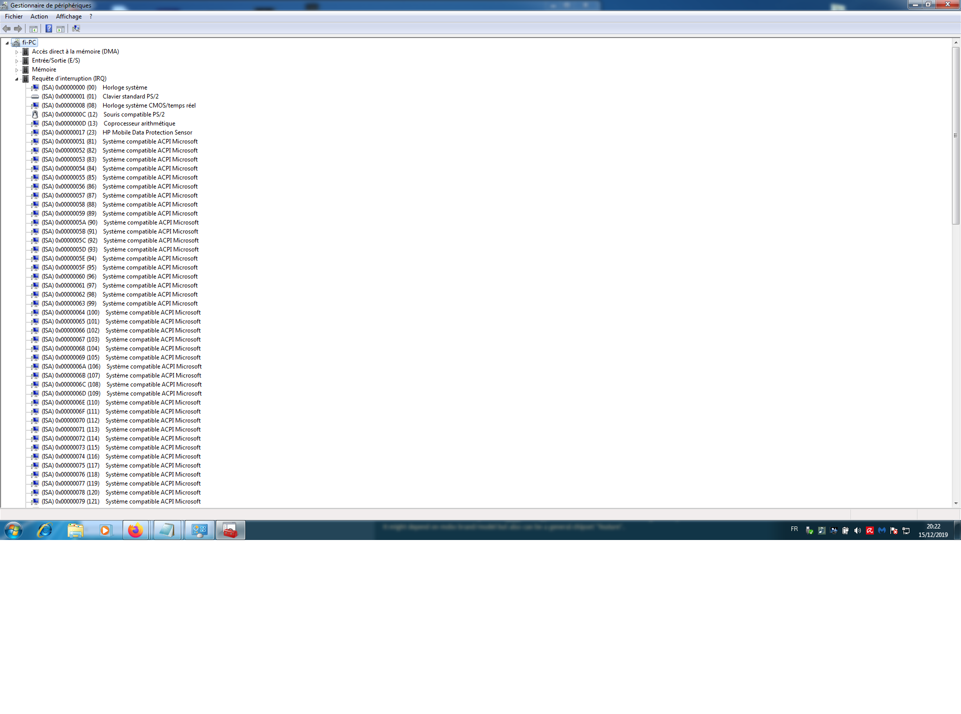

DISABLE ALL PERIPHERAL/IRQ THAT WINDOWS SHARED WITH THE PCI/PCI EXPRESS BUS OF YOUR SONICCORE CARD ! AND SEE !

asiofixer, everything shares IRQs now, it's all virtualized and there's no actual PCI controller anymore, even that is software. Please chill on the posting, we appreciate that you're back but GaryB has my permission and license to put you on ice again if this persists.
