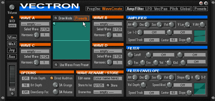

Jimmy, a new revision of the preset file is now added in he "preset" section, now including the Virus wavefforms :)
Dante, i now added a quick screenshot in the "presets" section showing where to load these presets :)

Heres a GIF animation I made of loading up the vectron with one of the Fairlight waves, have I got it right ?
If so l will use it in ScopeRise 'how to' guide illustration.
vectron wave loading

yes thats right perfect

Basically it is right, yes :)
However most of the magic is done in the ProgOsc Section when it comes to sound design after the presets are loaded as you show here. You will need to select the wave from the dropdown menu within ProgOsc. When you select waves within wavecreate, you can morph between up to 4 waves (as you show) to create a new waveform that can be saved in a new user slot.
