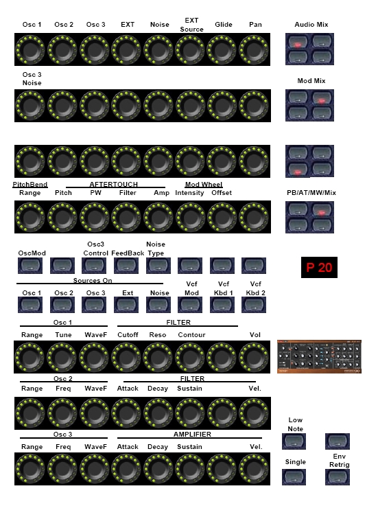

Following the Pro-One and Prodyssey template, here is a Minimax template for the noah.
This one is just an adaptation of Henrik one to match the organisation of the pro-one and prodyssey template ( http://www.planetz.com/forums/viewtopic ... orum=33&12 ).
Keep me inform if improvement is necessary
BCR2000 Template for NOAH Minimax
- BCR 2000 noah Minimax template v2.jpg (264.13 KiB) Viewed 5468 times
- Noah_Minimax.zip
- Include a sysex file to be downloaded to the BCR2000 and a jpg to show the mapping
- (255.67 KiB) Downloaded 511 times

I have played around with these templates in my head for ages now
Trying to make a "global" layout.
Wouldn't it make sense to shift the MiniMax ATTACK, DECAY, SUSTAIN LEFT by 1 to make it closer to the Prophet 5 etc.? That's what I did on my own version right now and it works quite good mentally.
So the Prophet 5 "Release" position is just empty for the MiniMax.
We could even come up with some logical generic names for the other ones. The MiniMax and Prophet 5 isn't really that different on the lower 24 rotators.

I already thought about it, but started with your MINIMAX template actually.
I will do so as soon as I find time (christmass is near ...).
The original idea I had was to build up something rather identical for MINIMAX, PRO-ONE and PRO-12. For the Prodissey, this is abit more difficult as the one of the enveloppe is AR only rather than ADSR and both enveloppes are not dedicated to VCA or VCF.
Will update this as soon as I can...
Thanks for the feedback.

Adjustment done ... one month later... or the next yearHenrik wrote:
