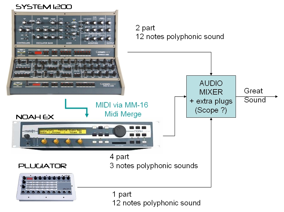

More than 2 years after the initial idea, I finally decided to do it this way:
The way I finally did it :)
using system 1200 to remote control noah ex.jpg (260.16 KiB) Viewed 3613 times
Meanwhile, a Plugiator provided 1 extra instrument... and I finally decided between the MINIMAX and the PRO12 by choosing both !!!
I really feel my dual BCR 2000 + X-station setup is great for remote controlling the NOAH/Plugiator/Scope plugs and other hardware synths but the ASB control surfaces are far more straighforward !!!
CheerZ
