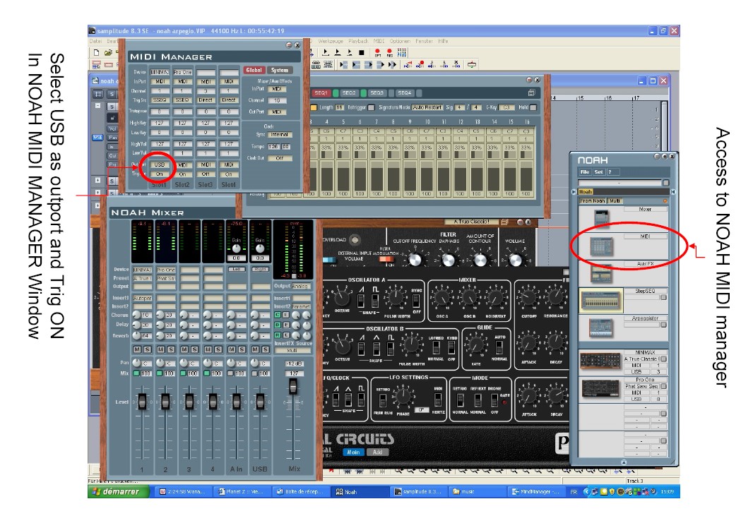

The trick I use to achieve that.
I do not actually use Noah physical MIDI Out but the USB out as this allow me to remap the output using one of my midi sequencer.
In the example bellow, I routed the NOAH seq Out to the USB of NOAH using the NOAH midi manager (see image).
Then in Samplitude I selected the USB NOAH in as an input on one track were the out is sent back to another hardware synth (a microQ actually) wich does echoes the seq.
Should work the same for the physical hardware midi out and also for arpegios...
Hope this would help...
CheerZ
NOAH seq MIDI out 2 other Hardware synth.jpg (236.23 KiB) Viewed 3021 times

I tried it with the sequencer and it worked, great! But unfortunately It did not work with the apreggiator. Did you tried it also with the arp?
