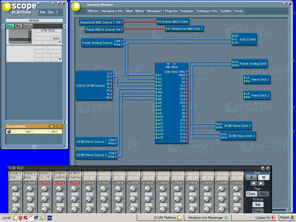

are you using a midi controller with cubase on the project that doesn't work? can you post a screenshot of your project ? the last version was a file i don't recognize. just hit the "print screen" button and then open paint and paste from the clipboard and save as a jpeg or bitmap.

thats the one making trouble
i couls get only a bmp file- and it isnt uploading
how do i send it as a jpg??

Post by danieldude »
got it!!!!
ללא שם.JPG (138.87 KiB) Viewed 2041 times
Posts: 8457
don't nail me down on my memory, but isn't it either Wave(16) OR Wave24 bit ?
danieldude
Posts: 32
Joined: Tue Oct 31, 2006 4:24 pm
im sorry ' whats that now?? :-?
Astro means, the wave in/out modules come in different tastes, and you should use only I/O modules of the same family - if that isn't the case :-)
:) allrighty then, but i have the same wave source\dest 24bit.
buy the way, do you see something there (in the connections) that dosent seem right?
like the asio dest 2 ... why 2? whats wrong with 1? :)
by the way , when changing the asio dest and source to - " asio dest" and "asio source"- (no 2 or 1) things are cakmer with the frezzing.
any idea why?
