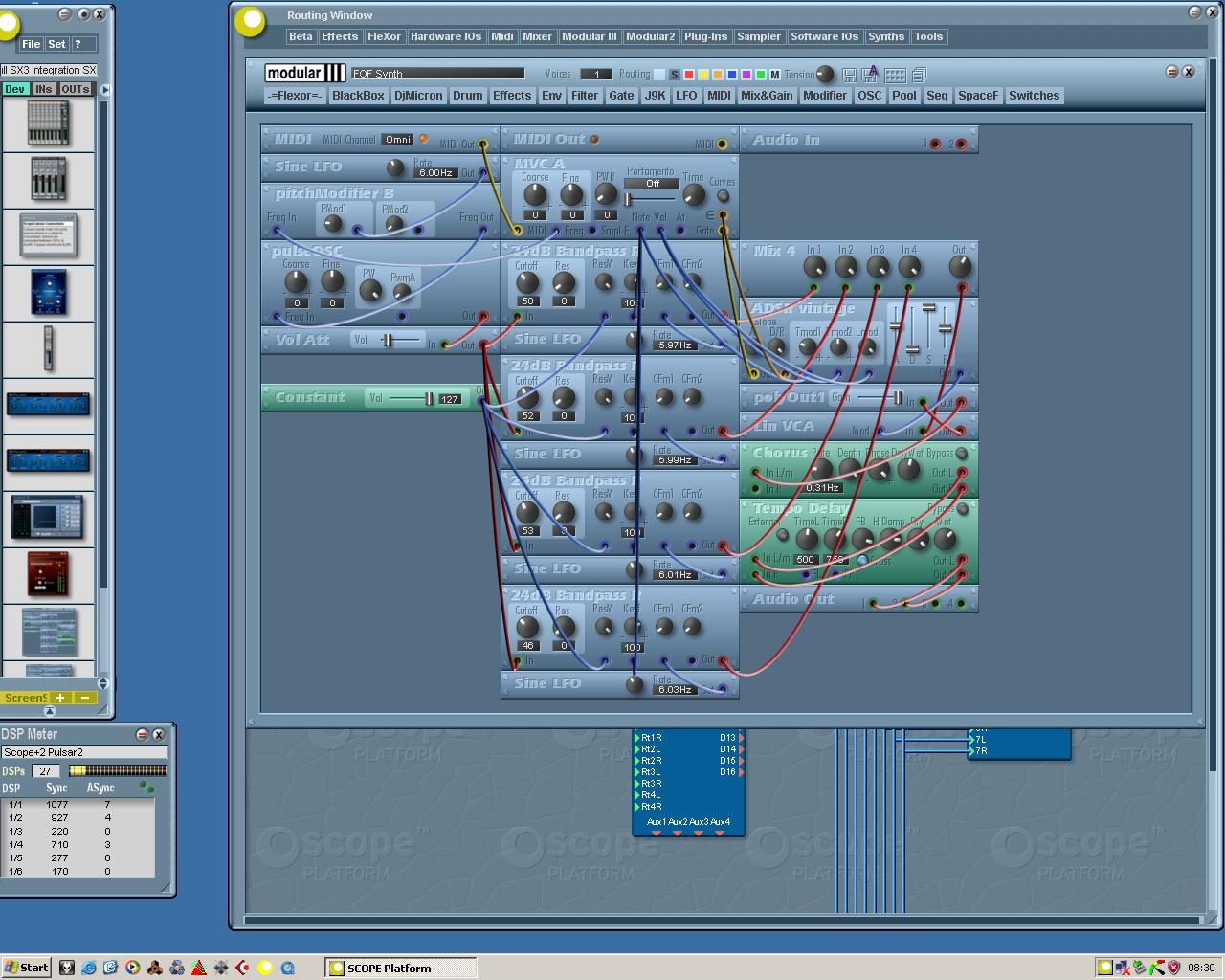

Does someone have an FOF and/or VOSIM patch he's willing to share?
I'm having some problems syncing everything, and therefore my own patch suffers many clicks and distortion.
Thanks! :)

Thanks, now I just have to find a way to do this properly with Modular.
I've already posted a thread (I should continue) about the problems I have syncing the fof's envelope trigger and the sine osc phase together...

There is one included in the included ModIII patches.
FOF Synth.JPG (191.22 KiB) Viewed 3150 times
