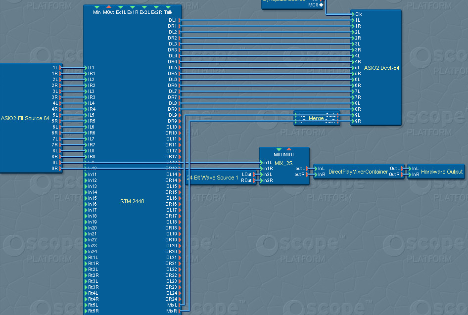

Ok,
Open your XTCproject.pro in the "Scope/App/XTCApp/" folder.
In your situation you must layout the project like my picture examplifies.
Two important things though (!).
1. The mixer you use in the project must have a .MDL file extension, not the usual .DEV extension.
To do this, create a new folder (i.e. "/XTC/") under "Scope/Devices/". Copy the mixer of choice (i.e. 2448) from "Scope/Devices/Mixer/" into your new folder. Rename the file extension of the copied mixer (i.e. "STM 2448.mdl").
In the routing window of the project there should now be a XTC folder. Use the mixer in there.
2. If you would want to manipulate the mixer (which you probably would want to do), the mixer panels must be open when you save the XTCproject.pro.
Now, try if you get that working.

Hey voidar,
thank you for this great setup. Unfortunately i cannot see what you connected to CLK of ASIO Dest. Why did you connect this CLK of ASIO. Until know i never used this connection. Is this connection necessary in all XTC projects?
MB Asus P5K-E, 1 x Scope 1 x Pulsar 1 x Elektra: Scope is the host, Winxp Prof, BCF2000
voidar
Posts: 1264
Location: Norway
Re: STM 4896 in XTC-Mode WORKS!
Post by voidar »
That's the Syncplate source. It's not necessary, but I had my A16U set as master via wordclock, so I figured it might be usefull.
It's only used if you need sample accurate clocking with external hardware. Google ASIO2 Sync.

Hello...
Since yesterday I'm trying to get the stm mixers to work in XTC-mode. I connected it just the way like Voidar's example.
It seems to work, but one thing I don't understand; when adding synths in my DAW (Ableton 8 ), I hear them all playing, but the sound of all synths only goes thru mixer input 1 and 2 (stereo).
What is it I do wrong ?
