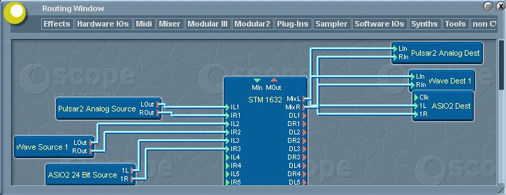

If you can manage to create this simple connection
you will be able to hear sound and record basic sound into your sequencer
dont forget to at least make sure you have powered Speakers hooked up to the left out and right out on the cable whip that isd hooked to the back of the card.
your sequencer must be started after Scope and that you have selected the proper drivers in your sequencer for Scope.
more info about what you are trying to do exactly will give the rest of us more ideas on how to get you started.
- Scope.jpg (33.72 KiB) Viewed 1077 times
