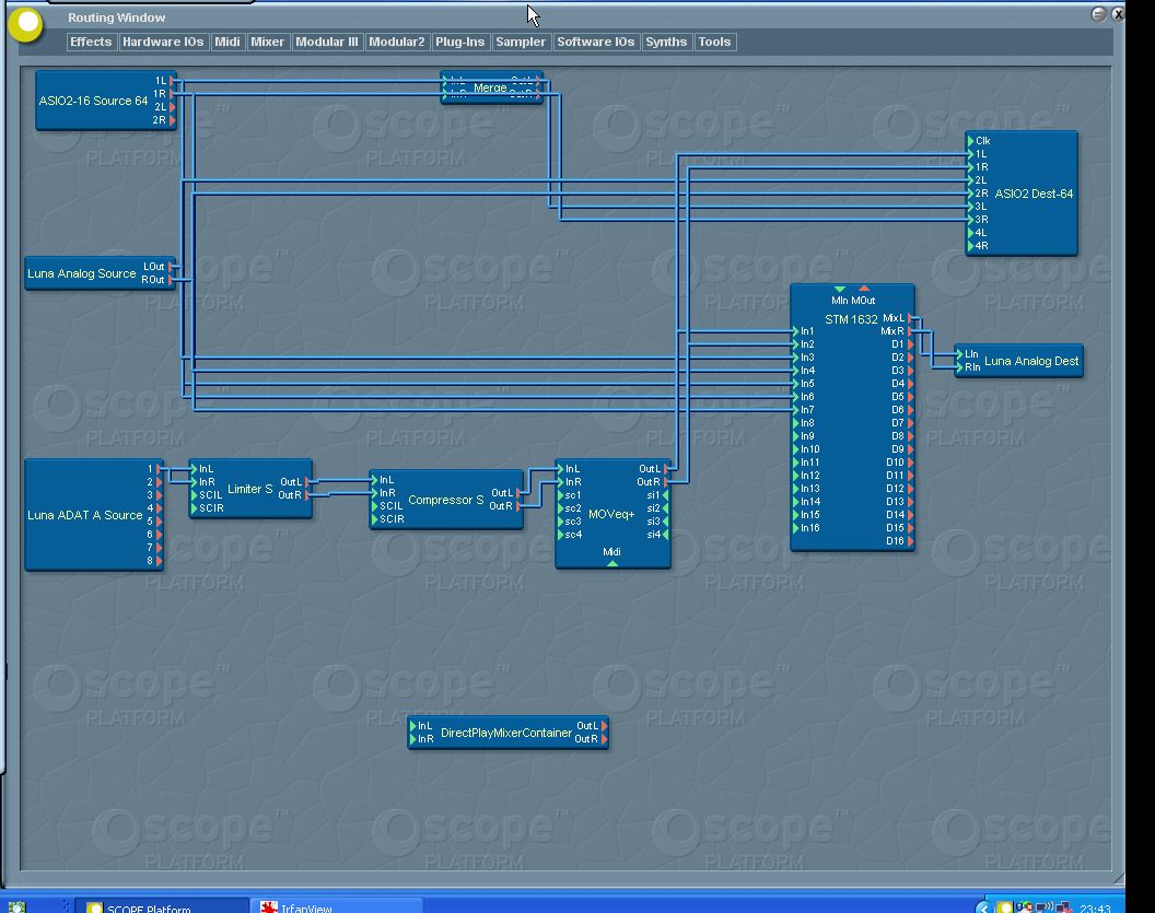

I've used the XTC project for routing but the XTC Effects are still brown colored :(
I Think, there could be two reasons:
1. My routing is still wrong - so I atached a screenshot of it (the effects at the ADAT Interface are just for the Vocalrecording - not for XTC)

you have to rename all .dev extensions to .mdl (or the other way around) and put them in the VST folder.
No XTC on Macintosh, so I don't know exactly the ins and outs.
Try a search on planetz for something like XTC renaming trick, maybe it is in the tipps and ticks forum.
Someone will help :-)
everytime you start in scope mode, cubase disables the xtc plugins(they're unavailable in scope mode). reenable them in xtc mode and they should work.

xtc plugins can only be used in xtc mode. the can only be enabled in xtc mode as well. why do you need xtc mode? just to use them in the cubase mixer? i don't find that to be any real advantage(i really thought it would be at first, years ago), but if it works best for you, it's all good.... :wink:

that xtcproject.pro won't work. you don't get scope mixers and effects inside the project like that for xtc mode. you load effects in the cubase mixer in xtc mode, you don't get as many routing options, that's what it's for(although there is a trick to use the scope mixers in xtc mode). what happened to the original?

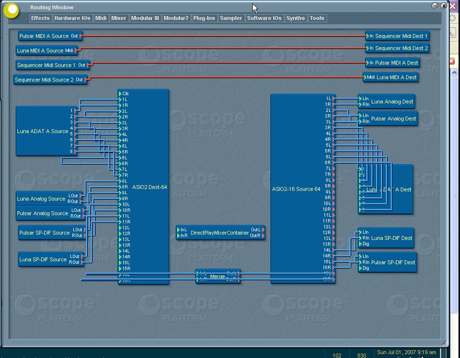

Know I can hear and record and the effects are not disabled, but I can't use them.
If I close Scope and start Cubase - the software can't use the Scope ASIO. If I don't close Scope ASIO is there and Monitoring and recording too, but the PlugIns are useless....
Here is my Routing:
