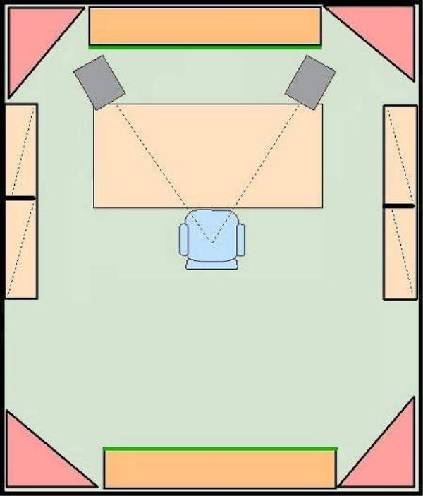

Here are a few bits of information I’ve collected along the way that you may find interesting (for a control room):
• Monitors should NOT sit on the console but behind, placed on heavy decoupled stands - console placement causes early reflection problems in most cases, unless the console is slanted down in front a LOT.
• Distance to wall behind speakers will change response drastically - there is a wall bounce calculator on the Acoustics forum that's fun to play with (needs Excel)
• Moving either speakers or your head by as little as an inch or two can sometimes make drastic changes in response, due to modal peaks and dips.
• Left/right room symmetry (at least within a foot or two of ear height) is important for good stereo imaging.
• Roughly 38% of total room length from the front wall
• Equilateral triangle formed by left, right mix position
• Monitor angles 60 degrees
• Monitor height – woofer at ear level (avoid mid point of floor to ceiling measurement – either sit higher or lower if necessary)
• Angled side absorption panels – left/right of mix position

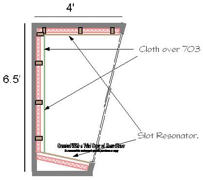

how to build a vocal booth:
http://www.johnlsayers.com/phpBB2/viewtopic.php?p=51632
iso/vocal booth
iso/vocal booth
how to treat a rectangular room (red: basstrap, else slot resonator, green: broadband absorber covered with cloth
