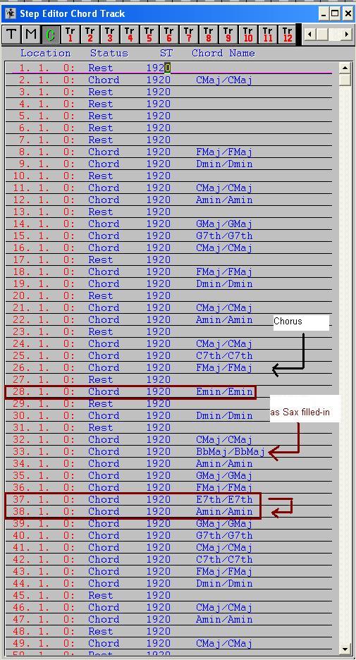

About the harmony issue, it took me a while to pull out the score with embedded chord arrangements.
Form there I know what you meant, there really was “Em” and “E7” in the aggressive chords and the Root key was C (not D or F).
Again, thank you for the listening and the comments.
P/S: I will post the Chord-Editor-Tool snapshot in shortly (for refference).

Hi Ken,
Here it is...Just for fun
My best,
LongStudios
Chord Editor View Snapshot
