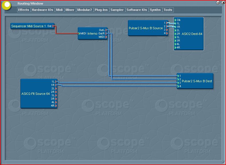

I have a VST instrument that is using a stereo ASIO2 with in Cubase then on Scope I route that particular source to my ADAT port in order to connect it to my external mixer and use it with one of my faders. During normal playback I seem to hear all my internal and external instruments just fine, all fully controllable with my external mixers faders. The problem starts when I need to bounce my mix down inside Cubase that the real problems start. Once I hit to record the VST instrument stops from emitting audio but records nevertheless, as for the rest of the of the external instruments, I hear them on my monitors but do not record!
Another persistent problem is that if I get to hear all the instruments while recording all I get is feedback inside the Cubase mixing environment. The external mixer is fine, it’s only when I make my connections inside Cubase, that’s when I get horrible audio like the same channels being played over each other.
Here is the routing that I use:
VST -> ASIO2 Source (1-LR)-> Scope ADAT Destination->01v96 ADAT IN -> main mix with the rest of the external instruments -> 01v96 ADAT OUT -> Scope ADAT Source -> ASIO2 Destination -> Cubase Main IN.
I think the problem lies within Cubase mixing and routing. It would be very helpful in some insight to what seems to be the problem I am doing, and would appreciate a project file for Scope or Cubase that will shed light into the routing.

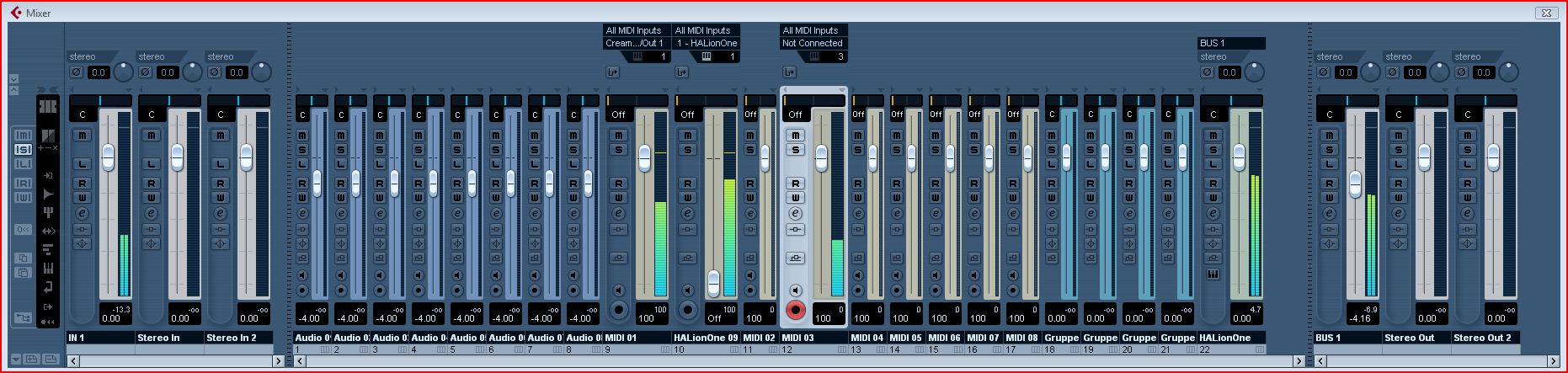

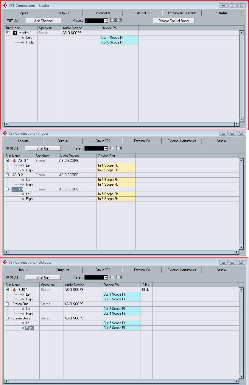

I tried to follow what you people said, but I am at a dead end. If I connect my VST to the second ASIO out, where do I route it to? and what do I do with ASIO-out 1 which is going to my mixer so I can control the volume with the external fader.
I have attached further pictures, this time with my VST connections and mixer. I have kept it simple for now just 1 VST and 1 external instrument. At the moment I get 3 different outcomes when fiddling with the routing:
1) I record external instruments but not VST.
2) I record VST but not external.
3) when I record all, I get feedback.
All I really want is be able to hear all my instruments while monitoring and then while bouncing the mixdown. Hopefully the images I provided may be useful for you people in order to guide me on how to correctly wire my setup.
Thanks.
Thanks.
If you refer to my external mixer, that is the connected with the ADAT on Scope, so I get 1 synth from Scope and the other from Cubase, like Halion one. while just monitoring both instruments play perfect. i can hear them crystal clean and fully controllable with my external mixer. Anyways, on my mixer my main stereo out is the ADAT channels 1 and 2 going back to my Scope ADAT and in turn goes ASIO destination 1 and you can see i in my Cubase mixer as ASIO 1 input.
Its only when i bounce my track I get all the trouble. like why if I can hear my VST instrument under just normal play, why does it dissapear under recording, I tried a few combinations like using a different bus to record or route it to group mixer and so on, but if I do that its when i get feedback.
There is just something that I dont understand in Cubase, I had logic audio back then and I never enocuntered this problem at such magnitude.
If possible can any one provide me with a scope and cubase project solution example, thatway I will load it up and see if the problem still ocurrs.
Thanks.
Thanks.
