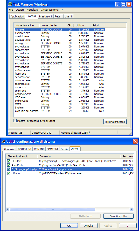

stardust wrote:check with msconfig which kind of autoruns are on your machine.
Maybe you find some recent entries that steel the CPU cycles.
Thx Stardust, I'm gonna have a look.
I'll also have to check again all services running.
Sorry, I was probably editing the 2nd post while you answering.
I added further details.
Cochise
Posts: 1305
Post by Cochise »
Autorun looks OK.
And I can't find out anything between running processes ( no audio software running in the screenshot ).
I wish to post the services list, but i've to translate it before. I'll add it next time.

No. svchosts have normal priority.
I've checked AsusProbe and it has normal priority too.
Just winlogon and csrss show high priority tag :-?
