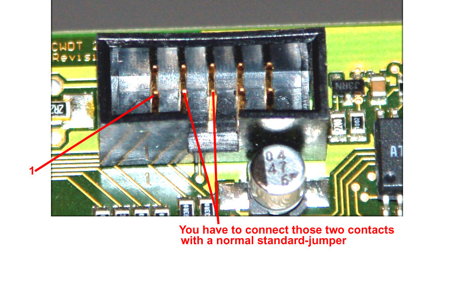

So far so good, but which pins are the ones to shorten ?
I´ve seen a photo of that some month ago.
It can be done with one or two "PC-mainbord-jumpers" !

Post by Telmar »
Problem solved !
I got this pic from Ralf Bach (SonicCore) and he allowed me to post it.
Thanx to all who tried to help ! ! !

Thanks Telmar, very interesting indeed....
I've just checked the defeater key I had received from Creamware while trying to get the Pulsars working without I/O with another card...
Guess what ? It is only a simple plug with no bridges beetween any pin.
Could explain why I always got this "no defeater key" message....
A fake defeater key ? :o
maybe it (de- or )connects contacts by putting it on it's place :-)

UPDATE It's even simpler than what we thought !
See : http://www.planetz.com/forums/viewtopic.php?t=23331
