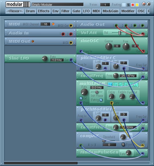

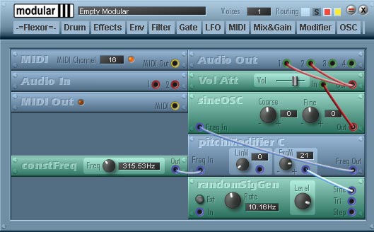

Cochise
Posts: 1305
Post by Cochise »
you could experiment with something like these (the second option if you like complications).
I'm instead wondering about the voice in the clip...
Cochise
Posts: 1305
Post by Cochise »
Sorry, the second patch uses ModIII modules RandomPulseGen and Compare AX.
It escaped me at first read you're using version 2.

thanks anyway! i get the point with the modular 3 setup.( but not the modules :lol: ).. maybe i can fiddle around and make a similar setup with mod2, or use the more simple version..
thank you very much! :D

I used a sine OSC for check it out, but it could sound better using other waveforms or a resonant filter modulated directly by the random signal generator, as you said.
Parameters setting is not that easy, however, even with the sine config. It tends to bark...
