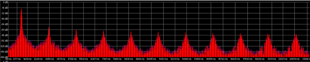

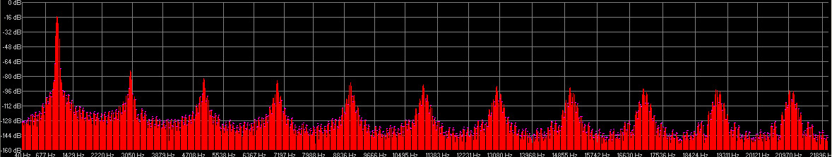

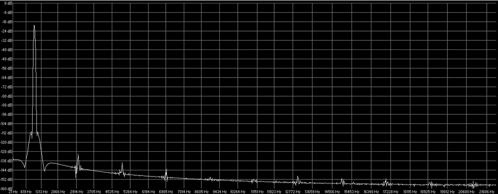

- DAS2A
- FFT-DAS2A-all-SETTINGS-CE.jpg (130.62 KiB) Viewed 4040 times
- Vinco
- FFT-Vinco.jpg (125.54 KiB) Viewed 4040 times

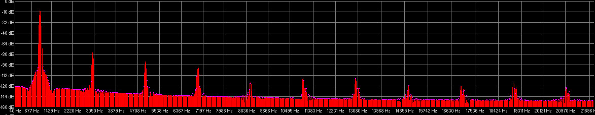

About "transparent" compression (2/2)

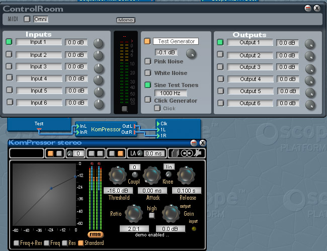

here is the same test with Kompressor to try to understand something
1000 hz at -0.1db from control room ,directly routed to asio2.9db attenuation.
Manu
Manu

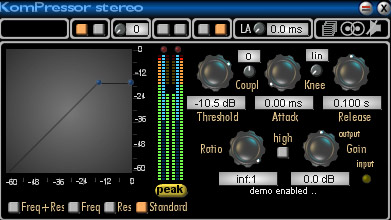

- Kompressor's FFT
- fft.jpg (155.54 KiB) Viewed 4038 times
- Kompressor
- KomPressor.jpg (33.73 KiB) Viewed 4037 times

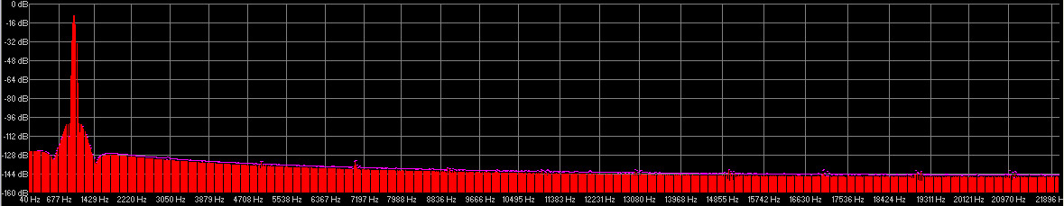

It's a strange concept, yes.
But if you look at the CW standard compressor FFT:
You see how it differs greatly from the others. The first harmonic is quite loud, which means it distorts the signal greatly.
Compression is distortion, but I guess what qualifies as "transparent" compression is to reduce a signals dynamic with little harmonic generation.
Anyway, strange, as I always felt the standard compressor was a very "clean" one.
Another important point is how something will sound. Not all harmonics are pleasing to the ear.
It would be significant to see FFT diagram of the original signal. (I'm at work so I cannot do anything...)
What are those harmonics?
I guess they are the step response of the time-windowed sine signal, which is limited in time domain. (It should make sense because they seem to be exactly on odd multiples of the fundamental => square wave)
For the little of digital processing I know, at first glance these tests don't tell anything but how much hi pass filtering the compressor applies to the signal.
So, is a compressor supposed to cut hi freqs?
Answer: I don't think so.
Thus the spectrum with higher frequency spikes seems to me the more transparent one could achieve: looking at the graphs the stock cw should be that one.
Cheers
Fede

yes, indeed, but I think here there isn't any capable of adding them, the harmonics are in the *source* signal imho (...and *always imho* the whole story about transparency is pure marketingmanu wrote:@fede,a good and "transparent" compressor don't have to add harmonics
the ear rules, transparency isn't always a good thing, I really appreciate Vinco "round" sound, a little darker mosfet-wisemanu wrote:but Kompressor sound's good,so,it could be a good choice for who want to get a colored sound
cheers,
Fede
Could you name the settings of the used compressors?
How did you dial in comparable settings? Wolf's Comp is very complex, so should spit out different diagrams in different modes !?
Don't these effects depend on Attack & Release-times too?
A fast Attack & Release of course do cause distortions& co.
Yes, of course the kind of Attack & co. too.

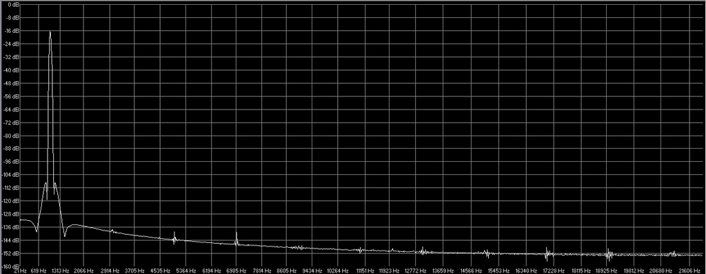

here are screenshot ,dry and wet signal:
and i like very much Vinco or others reason than you
I don't think so,and i need a clean compressor.I have learned how to make some test and i will use to use my new knowledge.
- bypass
- bypass.jpg (75.1 KiB) Viewed 3851 times
- fx
- fx.jpg (97.84 KiB) Viewed 3851 times

@manu
If you set attack & release to a maximum I bet that the standard comp has no such overtones, because it just adjusts volume. Just a guess. Smallest attack (attacks near 0.1ms-1ms) allways causes distortions to the signal. Are we the same opinion here?
If you set the attack low and the release very high you can stop a fast signal and avoid some overtones. There are other strategies to make comps react different, so how can I describe their behaviour with a Test?
Only with complex material. Same opinion there?
& how do I know that you used THE SAME ATTACK, SAME RATIO, SAME RELEASE. I don't know, if das compressor shows it in milliseconds, sorry I didn't dig too deep.
I just miss the settings for ALL devices used in your tests and doubt that they are comparable. So please tell me a third time
Have you ever played bass through vinco with lowest attack? It distorts the signal, because attack is so fast, that it reacts "too" fast, so that a bass-wave with its low frequency and therefore "slow" amplitude-changes causes compression changes. I guess this is what happens to any wave - to a certain degree when working with fast attacks.
So it is really very important to use the same settings on all comps in such a test + it is a must imho making it with audible examples, cause a compressor is not that easy to compare + different settings with their results etc. What, if the numbers they show differ?
What if smallest attack is 0.1 in one and 1.0 in the other?
I will not go too deep in this materia, but, why not discussing these aspects a bit. As allways I can learn much here.
Any chance of doing a test with my Varco, Tong, XLight? Or could you describe me, how to exactly do my own test? I mean which values I have to dial in the compressor to make it react comparible to the others. Yes, I know the values of Wolfs, but what about the other settings?
