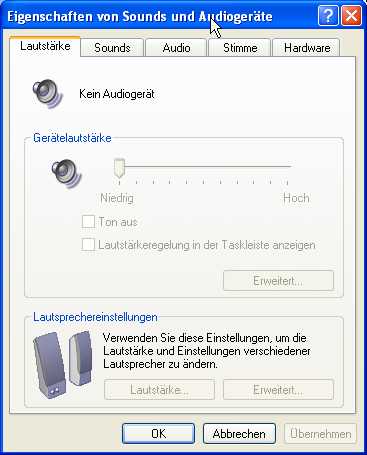

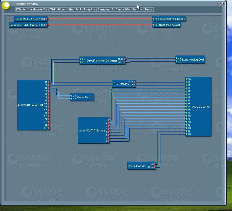

My Scope System realy works fine with Cubase, but I can't hear anything in Windows - for example with the Windows Media player or WInamp. The Wave dev and source is connected to ASIO.
In the Windows System is no Audiodevice listet (look at the screenshot) - I think this could be the problem. How can I add the Scope home board in this menu?
No Audio Device in Windows XP

That's normal it doesn't come up in that menu it comes up the device manager and in the following pages on that menu.Scope has it's own mixer it doesn't come up in that one.

your setup is pretty strange so far....
thats what I expected anyways.
keep cool! Everything is working correctly
I`m sure your wave driver is working fine, but your routing is mixed up!
try connecting the wave source 1 directly to the luna analog destination module and you will hear sound from meia player.
My recommendation: have a look at the creamware manual to fully understand the module workings.
the asio2 destination is for multi-channel asio recordings , the asio source is for bringing out multi channels from your sequencer to a scope mixer or multi analog outputs.
In your setup the mdeiaplayer is routing its sound into asio channel 9 and so you can just record it in your sequencer if you switch over to asio channel 9.
If you wanna hear sound connect it to the luna analog output.

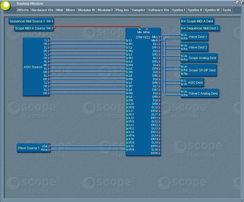

If you want to monitor multiple audio sources (asio source, wave source. and so on) on one analog output (like the luna analog destination) you have to use a scope mixer device, like in my following setup.
have a look at it:
once you understand the workflow its very easy to work with. You just not yet fully understand the intended workflow of fthe different modules.

looking at your project, i'd say it was an xtc project.
i hope this provides some useful hints.
now,
windows sound uses the wav source module, you can think of this module as windows programs' "output jacks". if the windows sounds go out this port, where does the sound go? i see that the wav source module is wired into the asio destination. well, that means that the sound is going out the wav source module through the cabling, into the sequencer(cubase?) via the asio dest module(the input jaks for the sequencer).
in order to hear anything coming from windows, you'll have to monitor a track in cubase with the ports that the wav source module is connected to and an output to the l,r output channel, which is connected to the Luna Analog dest(the hardware outputs). in any case the wav source has to end up connected to the Luna analog destination to be heard outside the computer.
this is a place where scope mode is really easier. in scope mode, you'd use a mixer to feed the asio and wav sources(and anything else) into the Luna analog dest. i believe there's an xtc mixer in the devices section.....

Thanks for the answers
@ Tau: Thanks for the tipp
I try but after using the IO Enabler (and rebooting) the media player didn't find any Creamware device anymore.
@grayb: you're right, it's an XTC Project and in this routing window I can't connect the Wave devices with the analog out device. If i load a normal Scope project - multimedia for example - I can hear Soundfiles with the media player.
Maybe it's just not possible to use the Wave device for Windows Sounds in XTC

Xtc only Works in ASIO mode i.e. Cubase etc .and not in the windows wdm mode.I don't quite understand what you're trying to accomplish ?
