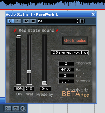

Is it possible to make a device of reverb for the use of impulses of WAV???
As it for VST:
Thank you for your work! it is good! Very well!
As it for VST:
- RevolVerb Lite.gif (69.96 KiB) Viewed 5652 times
