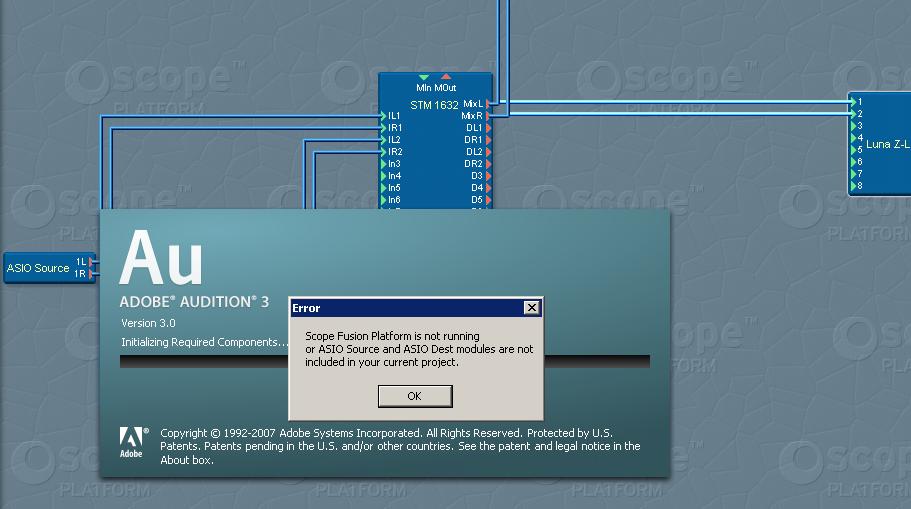

Thanks all for reply, well it's working normally without any problem in XTC mode in audition 3.0, I'm using asio driver and i can see all input/output of my scopes...
Except if I'm using the sfp, if i will choose the ZLink A dest from Luna card, i get one error, i will post a screen shot tonight...

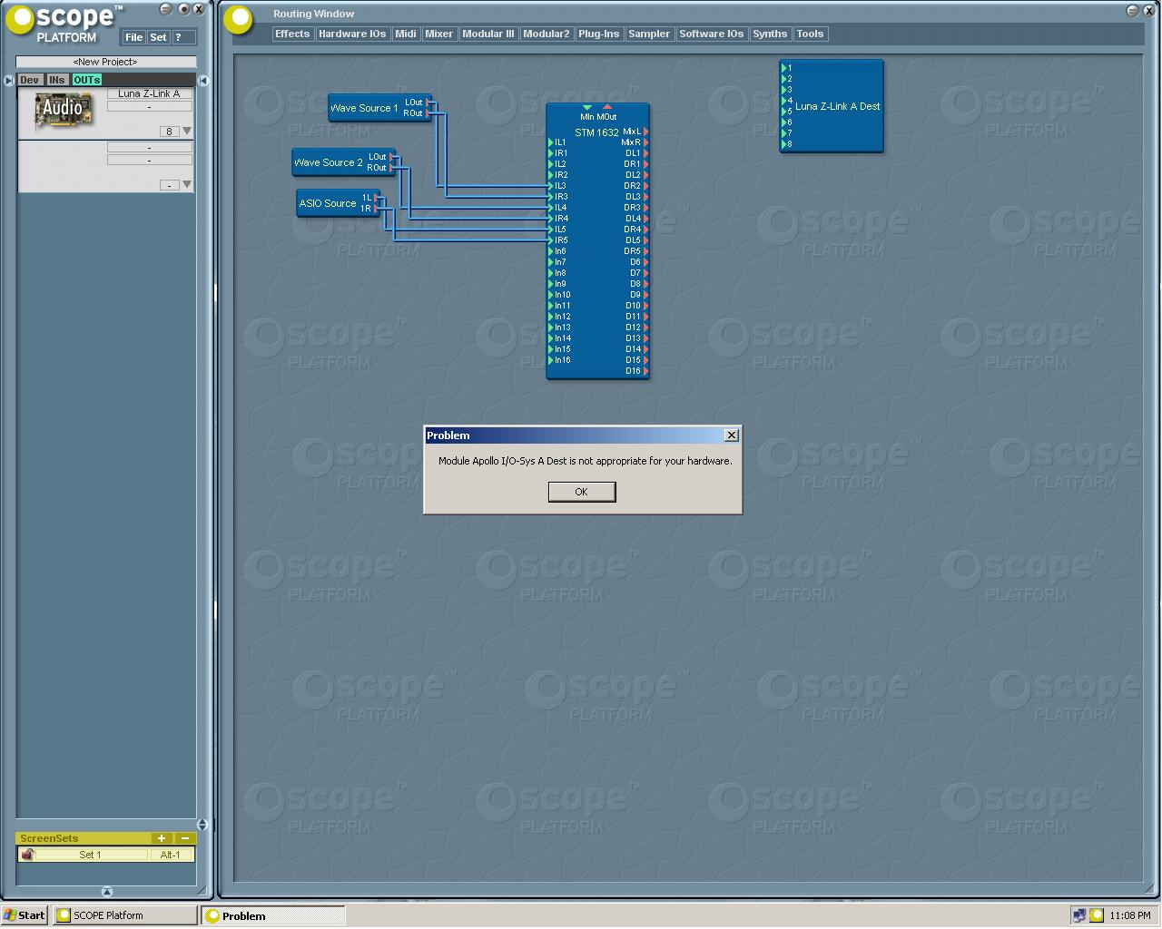

I'm getting this error if i load my Luna I/O in sfp, and no error in XTC mode...is there's anything wrong that i'm doing?
Regards,
Ladiki
Posts: 23395
is there anything connected to the z-link module?
perhaps running the installer again(over the top of the old install) will help....

@ garyb, no there's nothing connected to Luna I/O, i installed scope again, still the same...
@ stardust, concerning a source module in routing window...an asio source could be ? or you mean something else? because even if i'm choosing zlink S before or after choosing zlink Dest, i'm getting the same error.
I have Audition 3.0, and with XTC mode is working normaly all input/output are ok in multichanel or edit view...
But in sfp window i'm not sure what should i do? please if some one use audition please give me a hint.
PS: i really would like to deal with sfp not xtc...
Regards,
Posts: 23395
i believe the luna box or an A16 needs to be connected to the z-link ports for them to work without an error message.
in Scope mode, the asio source and dest modules are the hardware audio ports for the sequencer. the sequencer midi source and dest are the midi ports. these must be in the routing window with the proper number of channels BEFORE you open audition. this way the sequencer knows how many ports to configure....check the manual... :)

I'm still getting this error <Module> if i installed my scope project as first card.
But when i installed my scope home first with scope home 4.0, then
installed my scope project and upgrade to 4.5 the error gone,
And as i know that it should use the big card as first card... so what should i do ?
Is there's any harm to have the scope home as first card and the project as second....
Regards,
Ladiki
tgstgs
Posts: 526
Post by tgstgs »
edit cset.ini to define board 0 and board 1;
look into manul there it is explained!
