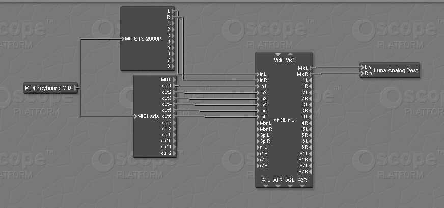

Okay, ive got scope running and can bang out some masterpieces with this little home card(mmmm dsp chips), But i havent the chance to do just that because of the freezing while composing bit going on here.
WinXP sp2
Intel Dual Core 2 Duo
Nvidia Nforce 570 SLI MoBo(c19xe&mcp51 chipset)
Geforce Nvidia 7100 Video Card PCI-Express
system drive, seperate audio drive and one storage drive
1 gig ram ddr2
Ive read and read and read and read.
i eliminated the active sensing bit by unplugging my usb keyboard, ive stopped using the midi source/dest routes, i even prevented xp from using the wave/directsound sound portion of the card by disabling it in device manager. no irq sharing no forced hardware. Hell i even disabled the midi driver in device manager. (i am a bit of a techie)
the last thing i tested caused it to crash.
just the scope midi keyboard, i tapped a few keys and it froze
All Scope by its lonesome.
I have stayed up late nights until the crack of dawn and beyond to get this right. I will not give up. I feel the solution is a simple thing. as so are "needles", But the "haystack" presents a problem. :wink:
all advice is welcome. :)
p.s. as of the end of this post i will further eliminate the scope keyboard split to the 2 samplers and feed just one.
I go to sleep now it is 10am in the morning
P.S.S Manic, we will be ready this evening.

Posts: 23395
that's VERY strange.
Scope midi has it's problems, sure. but it's normally very dependable talking to the sequencer.
i've done quite a few installs and everything works, like everytime...except when there's a file system problem or if there's broken hardware somewhere...
Scope cards may make life easier for the cpu, but they are very demading of the motherboard and will show flaws that other audio cards won't...
i have seen a broken wire inside the d-sub on the cable whip make the system unstable before, it's worth checking since midi is an issue. also, you might as well try to reseat the card itself. i doubt that this will help, but it couldn't hurt. :)
