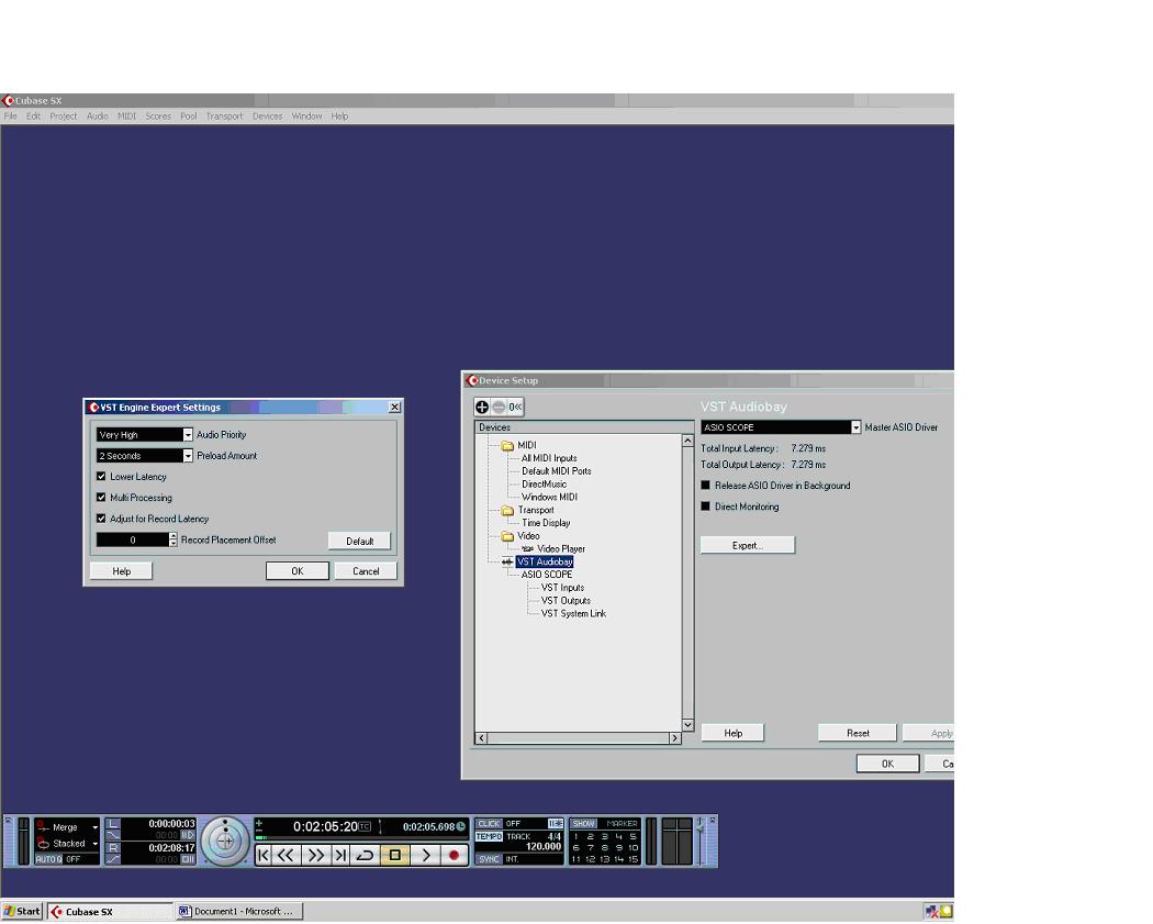

hey everyone well i tried many different things tweaks, check hd,....almost everything u guys listed with no luck. 2 things i think it could be is the irq sharing, i checked and on my creamware card there is no sharing but there are about 4 other devices sharing my pci express graphics card. anyone think this could be the issue? reguarding buffersize which is still a major possiblity i cant find buffersize in cubase. under device setup>vst audiobay i see master ASIO Driver, under is input and output latency, release ASIO in background and direct monitoring and expert tab, where there is audio priority preload amount, and record placement offset tabs and lower latency, multiprocessing, and adjust for record latency boxs.no buffersize
thnxs again

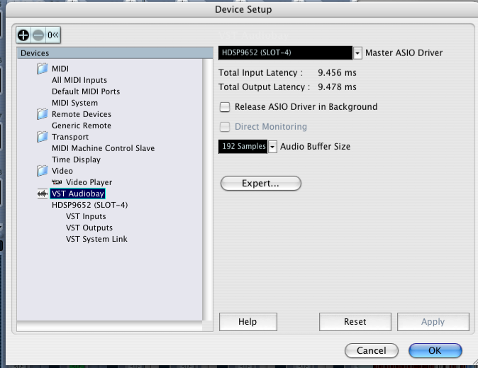

I use SX3 (mac), and this is what it looks like here:
Audio buffer size.png (79.57 KiB) Viewed 1794 times

ok, obviously on mac OS9 the audio buffer size is located inside Cubase, I can't tell you if Windows has a similar function on OS level.
sorry :-)

is it normal my buffersize doesnt show up in device setup?anybody know where id be able to locate it?
