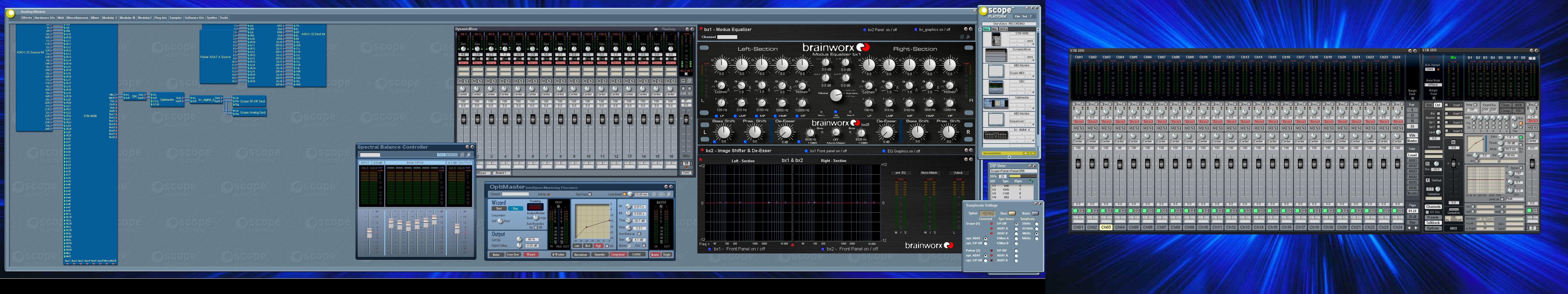

Here's a picture of my big nasty...
Used for tracking and mixing.
When I'm feeling adventurous I will even route out the Samplitude V10 mix out through Scope and back INTO Samplitude V7.23 for mixdown - similar to mixing 'outside the box'.
Basic idea is to at least start with ASIO source and dest modules plugged into a mixer, and let Samplitude see them. Should be very straightforward.
