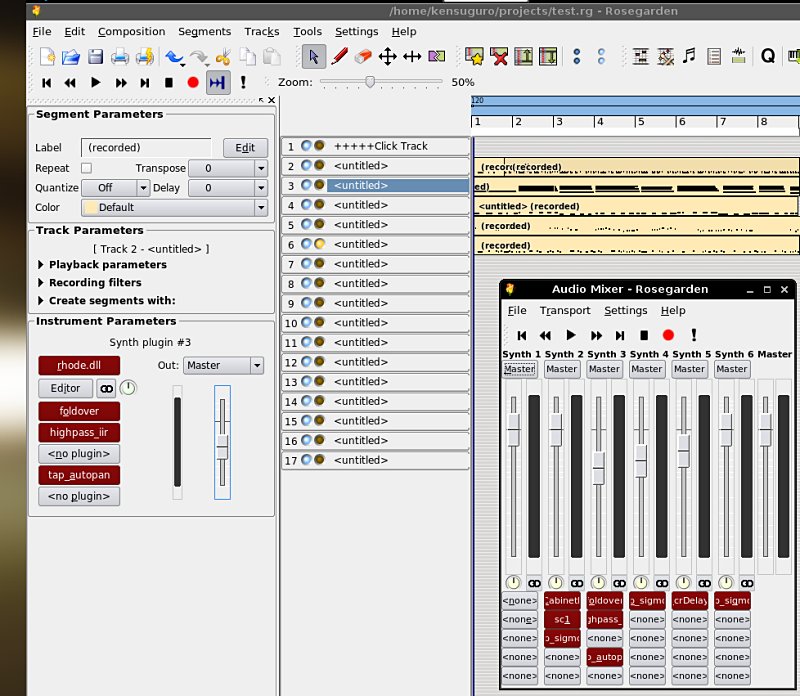

- The default trackview with the mixer. Notice there is no mute/solo, and also there is no master effects. You can add sub masters, but I don't think you can do aux sends.
- trackview.jpg (126.61 KiB) Viewed 5056 times

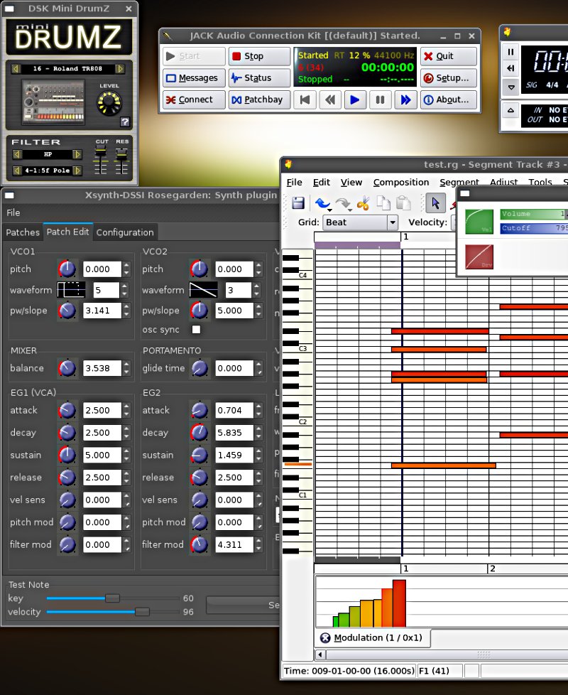

- VSTi running along DSSI. This DSSI synth is caled Xsynth, and it actually sounds very good. You can see a bit of the matrix view. Problem with the CC pane, is that you can't "pencil" in the values. You can only set 1 value at a time via righ
- instruments.jpg (183.66 KiB) Viewed 5057 times
